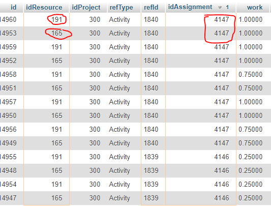

When i check on data base for these ressources i've got the same assignement ID for the same Activity and i don't know how it end up likes that.

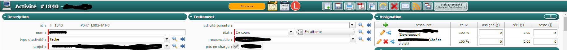

Another thing is that when i go back into Activity screen and i update the assignement the ID are differents for the profil "Développeur" and "Chef de projet" so why are they equals in DataBase?
Developpeur A ssignement :
Attachment not found
Chef de projet Assignement :

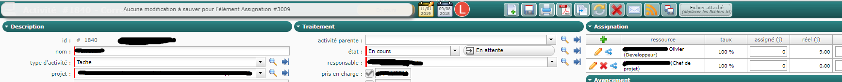

14 Jan 2019 16:13 #3 by bioN
oops,
with developer's view i've got "aucune modification à sauver pour l'élément Assignation #4147 "
16 Jan 2019 19:05 #4 by babynus
It is possible if resources entered work on assignement of a pool to which they belong.
The idAssignement refers to the assignement of the pool.

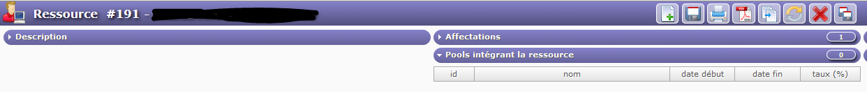

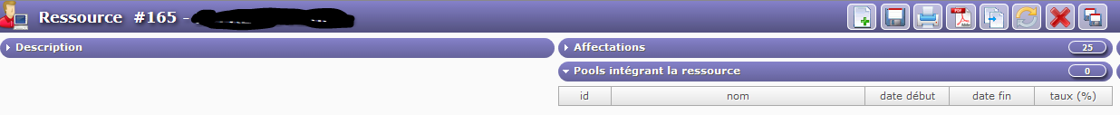

22 Jan 2019 09:06 #5 by bioN
hi ,
unfortunately they don't belong to any pool as shown below
22 Jan 2019 16:06 #6 by babynus
It may also possible (I think) if work is entered through Ticket.
Does the work lines have non null idWorkElement ?
