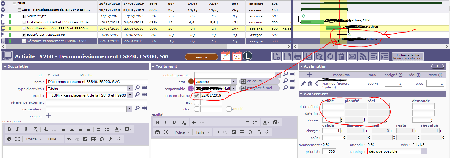

21 Jan 2019 15:10 - 22 Jan 2019 14:19 #8 by timshel
New try today on another project.
Creating a new task then assigning a ressource (and charge) to this task.
Re calculate the project.
Still no scheduled dates.
(see the attached file)

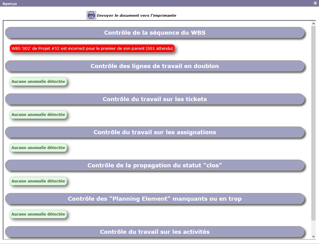

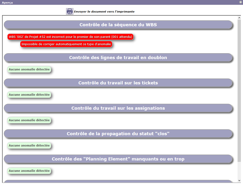

28 Jan 2019 10:20 - 28 Jan 2019 10:21 #12 by timshel
1) Fix planning isn't checked on project (and on project on superior level).
2) WBS structure seems correct. But Consistency Check report oan error and the script is unable to repare it. (see pictures in attached files)
I use v7.3.3
