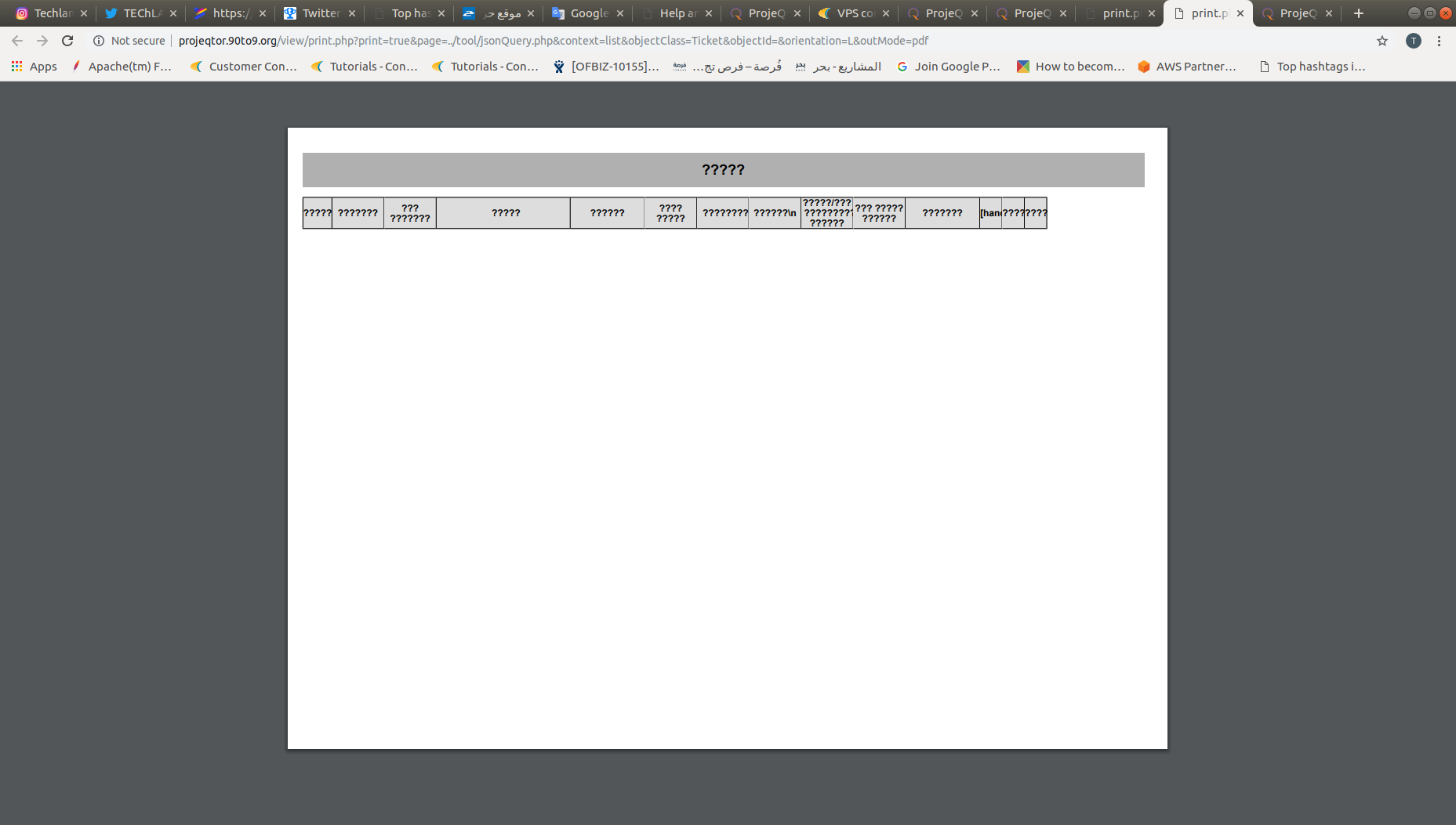

hello
i have translated ProjeQtOr to my Language (Arabic)
put we have problem whem generating a pdf report in Arabic Language
see the attached PDF
Can you please hellp me to solve the issue
This browser does not support PDFs. Please download the PDF to view it: Download PDF

In Global Parameters, tab "system", change parameter "font for PDF export :"
You should use freesan and not helvetica

i used the feesanse font but still same problem

As explained on wikipedia en.wikipedia.org/wiki/GNU_FreeFont, fresan includes arabic code blocks
Just to be sure, after changing parameter, be sure to diconnect, reconnect and try again.

i did as you said but still not solve

i am sure it's the font freesanse problem
because i was using another program which uses feesanse and i was getting same problem
when i used Arial font it solve the issue
can you learn me how to install Arial font in ProjeQtOr
