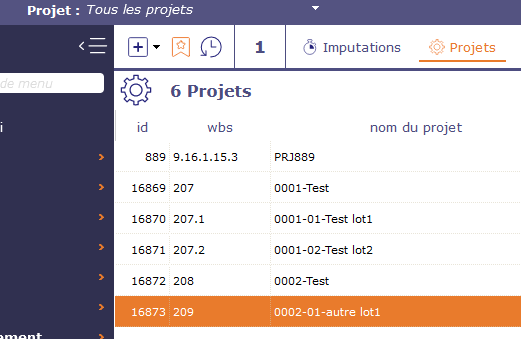

Test scenario
  1. Login as Project leader (affected to only 5 small projects)
  2. Create new project '0002-01-autre lot1', at root of project structure
    => Save operation is quick
  3. Update project '0002-01-autre lot1', set "is sub-project of" = '0002-Test'
    => Save operation is very long, and log traces show a huge number of projects are saved.
It looks like there's something wrong in the recursive save operation, because there are no dependencies apart from the parent project and the sub-project.
Can this help to figure out what could be improved ?

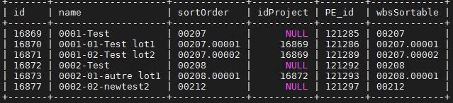

21 Apr 2021 10:15 #4 by caccia
I've tested the same scenario after upgrading to v9.1.2, but I am still seeing the same behaviour : when moving the new project to "is sub-project of" parent project, a huge number of other projects are also saved.
I checked the sortOrder, which looks ok and consistent between 'project' and 'planningelement' tables.  (In this case it's project #16877 that I'm moving to sub-project of #16872).
Would you see anything else that could explain this ?
