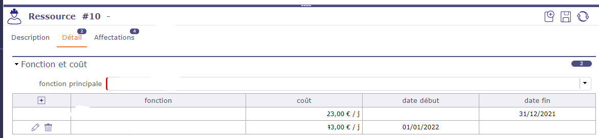

22 Dec 2021 11:13 #1 by Linaewen23
With the change of year, we have updated the TJs of our resources.
However, when we plan these resources on activities starting in 2022, the assigned is still calculated with the TJ of 2021.
This results in an offset of several thousand euros on our projected budget for 2022.
1 - Will the assignment be recalculated automatically on 1 January?
2- Is it possible to make the software evolve so that this situation is taken into account each time a new TJ is recorded? Is it possible to change the software so that this situation is taken into account each time a new TJ is recorded? Because this situation can also occur during the year.

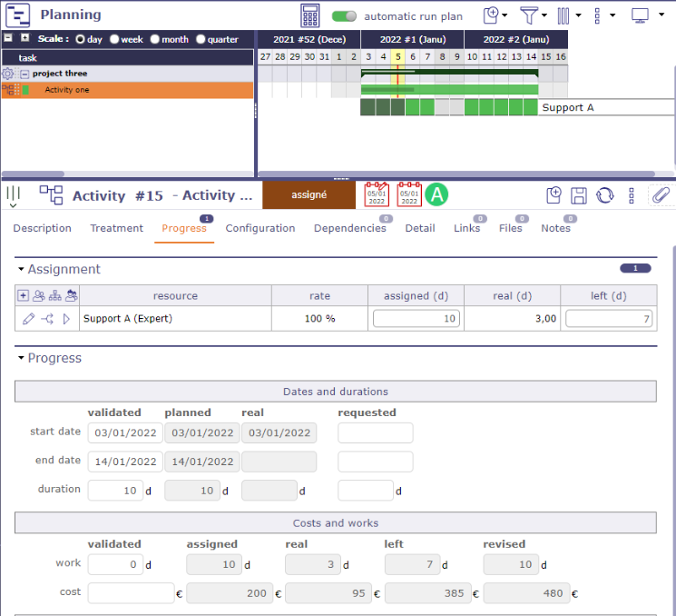

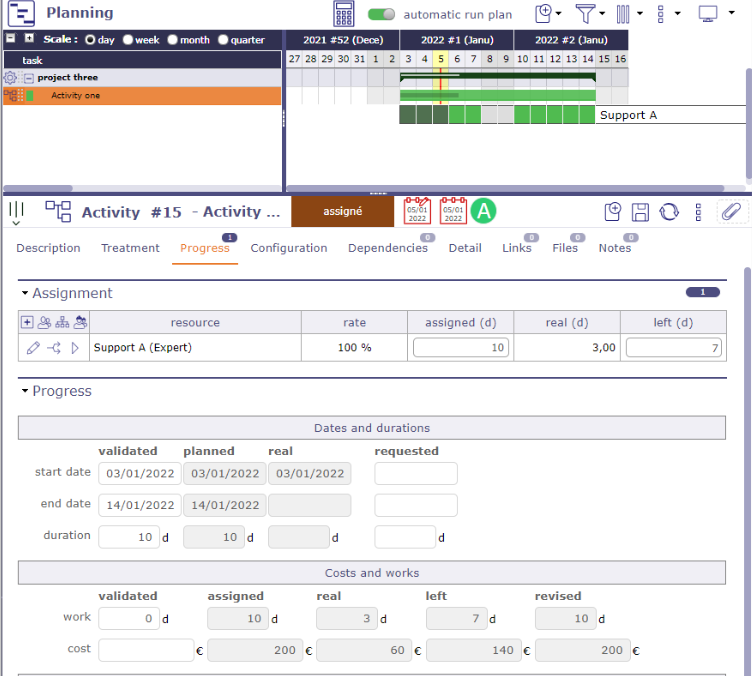

05 Jan 2022 12:55 - 05 Jan 2022 12:58 #4 by Arkhanje
but when I go to its activity the old cost is still used to calculate the rest and revised costs
No, that's not possible.
The cost of the function is calculated on the current date and is applied to the real, the left and the revised costs.
Only the cost on the assigned remains unchanged and on your capture we only see the assigned starting cost.
This allows you to compare the variances on the costs assigned at the start of the project with the new costs.
On the first capture you can see the cost calculation on the "support A" resource, estimated at 20 € / d, and planned over 10 days with 3 actual days until the current date.
So the real cost is 3 x 20 = 60
I change the cost of its function for 55 € / day from the 5th
You will notice that the assigned cost have not been changed. This is the starting assignment.
On the other hand, the real, the rest and the revised are well updated with the new prices
The actual cost = (2 x 20) + (1 x 55) = 95
It is about life. It was estimated X months ago that our resources would cost us (10 x 20) 200 euros for this activity and today, with the contingencies (absences, standby of the activity, evolution of costs, salary increase, .. .) it will cost you 480 €.

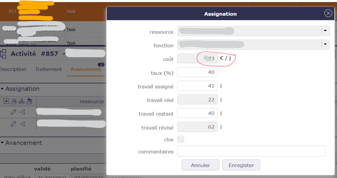

05 Jan 2022 16:21 #5 by Linaewen23
For your information I am working on version v9.2.4.
I noticed that the recalculation of the left and the revised are only done if the assigned resource has entered real after the date of change of TJ (January 3 in my case).
Also when there are several resources on the same activity, only the TJ of the resource that entered the real updates the left and the revised.
In my version the assigned is also updated.
How do I update the lefts and revises for activities that do not yet have a real in 2022?
Translated with www.DeepL.com/Translator (free version)
Bonjour,
Pour information que je travaille sur la version v9.2.4.
J'ai remarqué que le recalcule du reste et du révisé se font uniquement si la ressource assignée a saisi du réel après la date de changement de TJ (le 3 janvier dans mon cas).
De même quand il y a plusieurs ressources sur une même activités, seule le TJ de la ressources ayant saisi du réel met à jour le reste et le révisé.
Dans ma version l'assigné est aussi mis à jour.
Comment mettre à jour les restes et révisés pour les activités qui n'ont pas encore de réel en 2022?

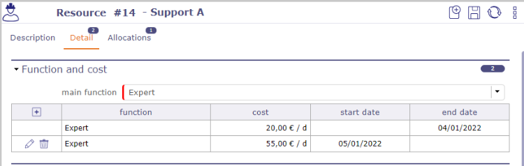

07 Jan 2022 16:09 #6 by babynus
Assigned cost is changed only if you "change cost" for resource (you edit the function cost).
This will overwrite real cost for past days (2021) and I guess this is not what is expected
You'd better add new cost ofr the reource, for same function, with start date on january 1st.
I can confirm that :
 - if you change existing cost : assigned cost is changed is no real work is entered, left cost is updated
 - if you add new cost : assigned cost is never changed, left cost is updated
