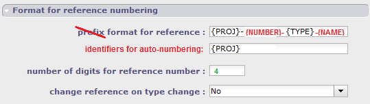

Regarding the auto-numbering function:
babynus wrote:
3- To define a few more parameters for "document referece": client code, folder code (see 4), client's project code (that may or may not be the same as our project code, see 5)
Is it a day dream ?
:evil:
Well, I may have been dreaming awake lately... :P
Anyway, I don't think this is a dream.
Indeed, I don't have a clue about the amount of work necessary to provide such a change in functionality, that's for sure... :unsure: so it's not like I'm demanding anything. :silly:
But, what I do know, is that it would be, not only a nice improvement, but also a really necessary feature.
Most companies have already established their own naming scheme. Probably, many years ago, and have already generated tons of documents with such a schema. It's not realistic to expect them to "swith" to Project'OrRIA fixed scheme.
I believe this proposal pursues the improvement of one of (in my opinion) best features of Project'OrRIA: to let portal admins configure it to suit their needs. It's just one more of those things that usually needs to be tailored.
So, to the point:
In order to be able to suit as most naming schemes as possible, the configurable reference should provide the option to select as many document's property fields as possible.
I'd propose to add, first, the following fields:
- Client's proyect code
- Client code
- Top Project code (the project of which this one is a sub-project of)
- (name)
- (version)
- (number)
NOTE: It would be useful if the fields "name", "version" and "number" could be added as parameters as well, so that you get to choose their position within the concatenated string.
NOTE (2): is common pratice that projects get divided in different "areas" (whether they're geographical or functional). An easy way to represent this in Project'OrRIA would be to create sub-projects for every area. So, including "Top Project code" as a parameter would allow to use "Area codes" in document's names.
All this, along with "Identifiers for auto-numbering", would solve the areas/folders/auto-number situation that I had mentioned previously. Which, by the way, was wrong indeed: folders are nowadays defined portal-wide (right?), and behave as templates for every project.
Example:
Project code= PROJ1
Number= 2
Type code= LD
Name= Test document
If the format for reference number was configured as shown in the picture:
Then the example document's file name would be:
PROJ1-0002-LD-Test document.ext
There's another feature that would be very helpful:
The numbering format is already a global parameter : "document reference format"
What I meant is a little bit different from what numbering format is capable of doing right now. I'll try to explain myself better:
As you can see in the picture, I'd propose two different fields: (1)"format for reference" and (2)"identifiers for auto-numbering" (actually, couldn't find a better name =p)
(1)"format for reference": I removed the word "prefix" as it would be useful to be able to select the order of the parameters (including number and name). These are the ones that define the concatenated string for the file name.
(2)"identifiers for auto-numbering": these would be the parameters chosen so as to manage auto-number process. For example in the picture, you'd use {PROJ}, {TYPE}, {NUMBER} and {NAME} so as to generate the file name. BUT, the only field checked to auto-number the doc would be {PROJ}. So, in that case, every doc within that proyect would have a unique number, disregarding all the fields you use generate the file name.
Similarly, if left blank, ALL documents uploaded to Project'OrRIA would get a unique number, no matter what client, project, etc, would it belong to. But the main thing here is that admins would be able to choose such behaviour.
Example:
- CASE 1: "Identifiers for auto-numbering"= {PROY}
You upload 3 docs:
DOC1:
Project code= PROJ1
Type code= LD
Name= Test document
DOC2:
Project code= PROJ1
Type code= HS
Name= Plot 1
DOC3:
Project code= PROJ2
Type code= HS
Name= Plot 2
So, with "format for reference" defined as in the picture, numbers and file names would result:
DOC1: number=1 file name=PROJ1-0001-LD-Test document.ext
DOC2: number=2 file name=PROJ1-0002-HS-Plot 1.ext
DOC3: number=1 file name=PROJ2-0001-HS-Plot 2.ext
When generating the doc's number, it checks the first available number within the project.
- CASE 2: "Identifiers for auto-numbering"= <blank>
You upload the same 3 docs:
DOC3: number=3 file name=PROJ2-0003-HS-Plot 2.ext
When generating the doc's number, it checks the first available number within the whole portal.
That'd be all regarding this. I hope I've made myself clearer this time.
Cheers! And thanks again! :cheer:
