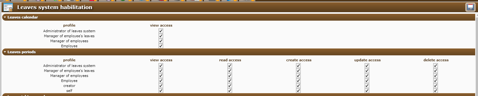

20 Jan 2020 09:21 - 21 Jan 2020 11:37 #17 by Tatatonio
Replied by Tatatonio on topic HR module leaves periods
Hi, many of the pb have disappeared with the WE...
I won't be surprised if a change in configuration, rights...needs a bit of time.
I add a screenshot of the leaves system habilitation. There is only one column for calendar (which should explain my imposibility to change anything on the calendar when I want to create a leave. Is this du to another habilitation or configuration ?
Thank you.
