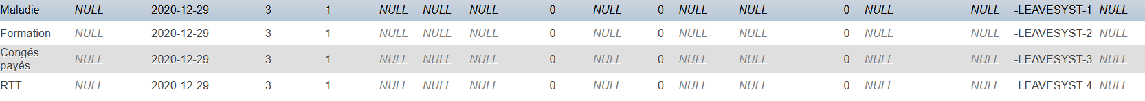

2) I created leave types in "parameters --> leave period parameters --> type of leave". As I'm french, I created CP, RTT and so on. (picture 1)

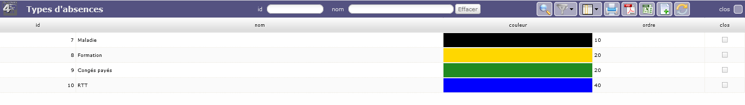

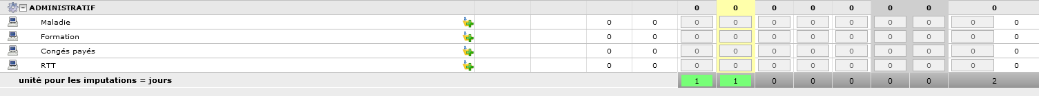

3) These leaves are automatically linked with my unique administrative project (picture 2). This Administrative has no "project code" (picture 3)

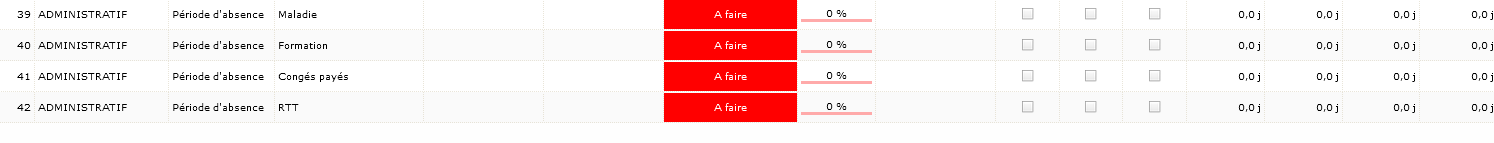

4) In the "imputation" everything is detected (picture 4).

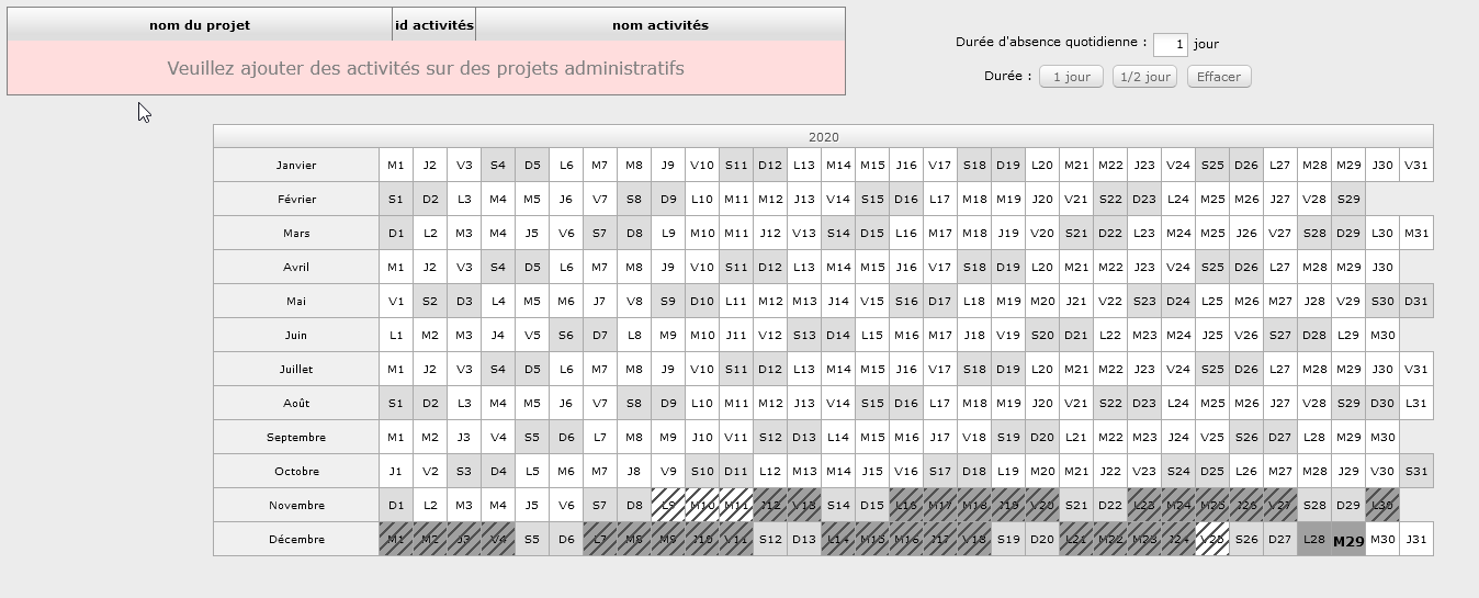

5) In the "Leave", no type apears (picture 5)

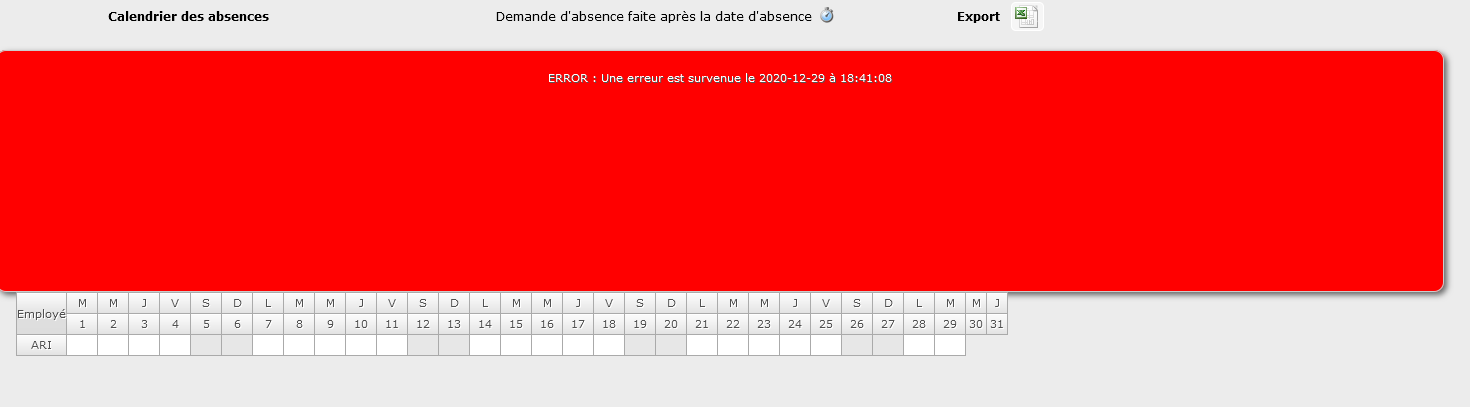

6) In the "calendar" I can't double-click to add leaves (pictures 6)
