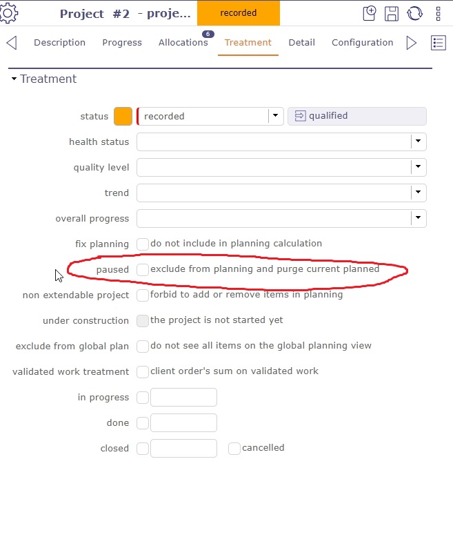

for unlock the project uncheck the paused checkbox in element Project on Treatement section.
Changing the status will not change this paused state that's why you are blocked.
27 Apr 2022 10:37 - 27 Apr 2022 10:38 #3 by Flou
Replied by Flou on topic Project is locked
This is this checkbox:

Yes, thanks, but every forms in the project is readonly... i cannot edit a single element of the projet.

Quick reply to myself, i have applied corrections via Configuration->Administration "correct errors". Did not see any change (so i have post this topic), but after a logout and re-login, i can see now that projet is editable !
That fix my issue.
