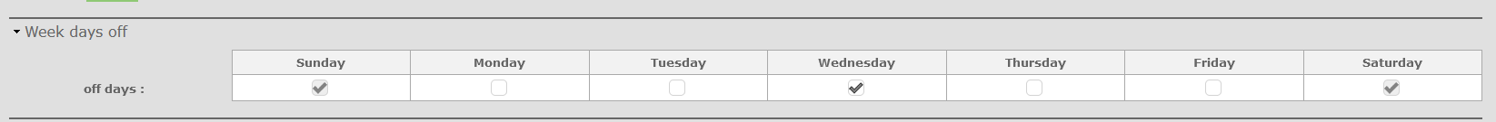

I've created a calendar for people working 80% - Wednesday being a kind of "day-off".
I can find the information on the calendar definition ("Week days off") - but can't find it through the API.
If I use the "Mark every" "Wednesday" as "off days" - they are all present on the Calendar object list, but I do not understand why the "Week days off" part which is working well on the tool itself is not reachable (or I can't reach it) through the API?

On the tool - calendar definition part - the Wednesday is indicated as day-off (see picture)
Could you please let me know what is the code needed or what I should do on the tool for having the Wednesday off days indicated through the API?
