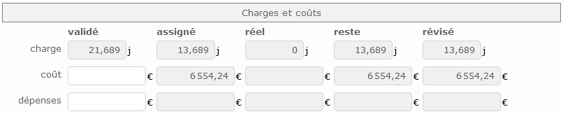

I have created a fresh new project with tasks : screenshot "before.png". All is saved correctly

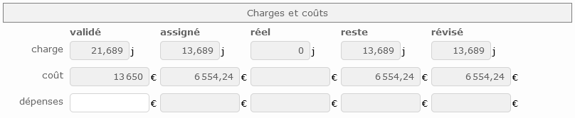

In order to monitor the global margin, I enter the price given to the client : screenshot "during.png" in the cost field
I save what I do and I have the screenshot "after.png".
The cost field is now grayed and I cannot modify it anymore...

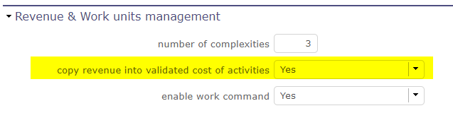

Check that you may not have activated the parameter that automatically calculates your validated cost
30 Sep 2022 13:49 #5 by matthieu.froment
I checked the parameters, and all is set to No.

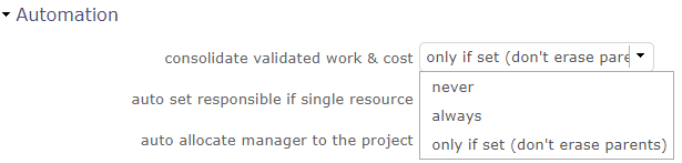

03 Oct 2022 10:04 - 03 Oct 2022 10:04 #6 by Arkhanje
Hi !
In this case it is surely the consolidation of the validated work that you have put on always or on if set.
The fields become read-only and will automatically update from the lowest element of the WBS to go all the way up to the parent project.
Global parameters > planning > automation > consolidate validated work & cost
If you do not want to consolidate this data, set this parameter to "never", in this case the validated data is not uploaded automatically
