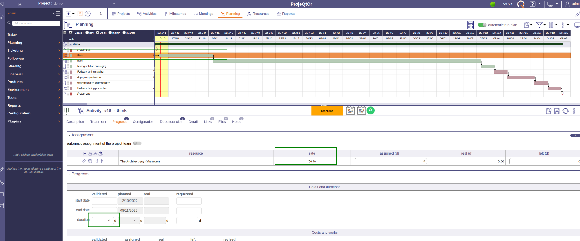

I suppose a simple project with a PM and an architect for a specific sequence, "think".
I set a PM with 1FTE and 100% daily rate and this architect with 1FTE but 50% daily rate on this project.
I expect the planning to get longer because I affected only this ressource for my 20d sequence "think".
However, even if I check "automatic run plan" nothing appends on the planning.
I tried changing the Architect FTE to 50% independing to the project or I tried to change the rate regarding the "think" activity within the project but no consequence on the planning
Thank you for your help

Hello !
your bars are pale green. This indicates that you have not assigned a workload to your resource. Look at your assignment table, it has 0 days assigned.
The validated workload that you enter does not affect your planning and recalculating the planning will not change this.
A short tour here will give you better information on dates, durations, work and costs
Last edit: 14 Oct 2022 09:13 by Arkhanje.

Hello Arkhanje,
You are so helpfull :)
I will test even if I believed I have tested it with a all green color but I should have made an error within this section
PS : I will update this topic to solved with my feedback when I am gonna to test it
Actually Arkhanje was true so I began to play with the assignement.
Regards, Christophe
