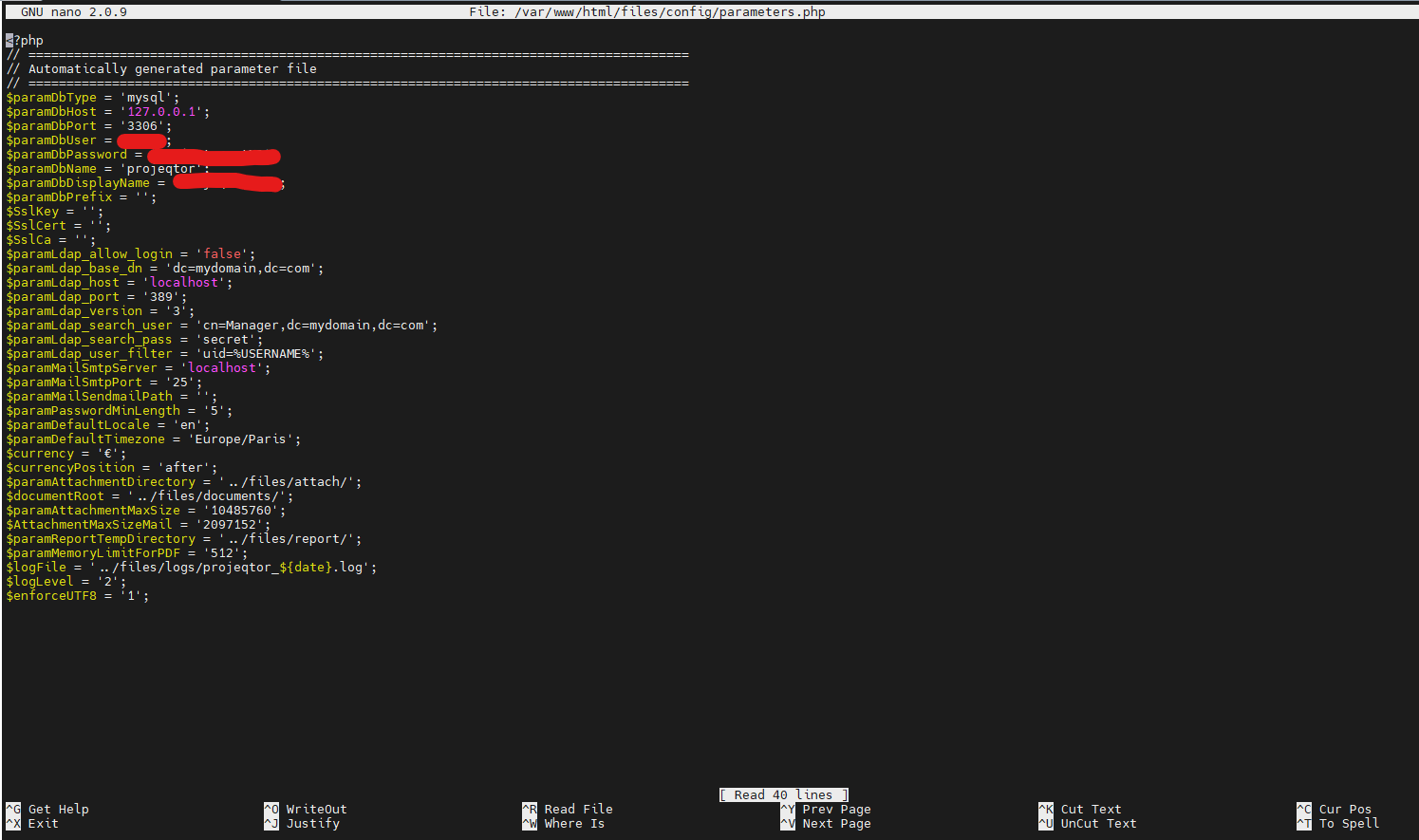

Similarly, I share an image of our parameters.php file, I see that apart from the database data there are records of some parameters, are those the ones that have to be deleted? If so, how do I remove them? I just delete them from the file?
15 Nov 2022 19:11 #4 by babynus
Replied by babynus on topic CONFIGURATION NOT SAVED
Yes, but once again you did not execute migration process as expected.
