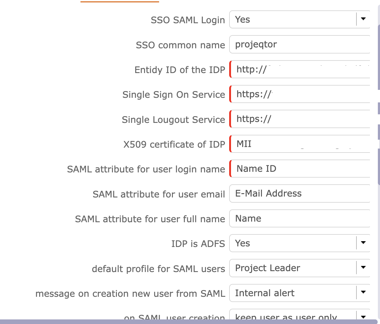

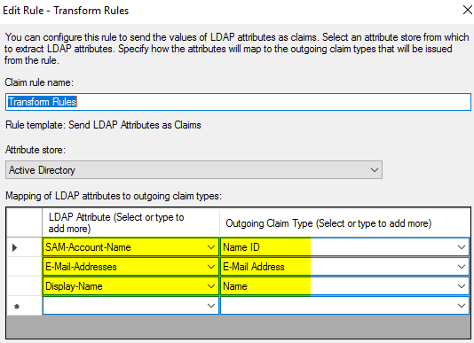

Hi,I'm trying to setup Projeqtor to authenticate using SAML2 through our organisation ADFS server.
LDAP is currently setup as follows with the following attributes:

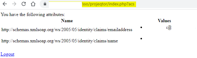

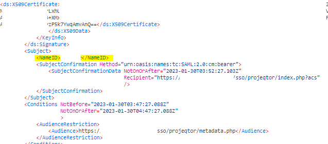

I can confirm that Projeqtor is talking to the ADFS server as shown below. SAML-Tracer results outlines NameID is being sent post ADFS authentication.
However, Projeqtor application does nor receive the "Name ID" attributes, and only received email and name attributes as shown below:
Projeqtor SAML2 is currently configured as below:

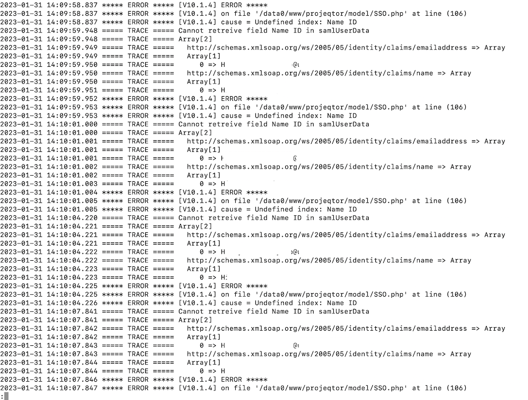

Looking at the Projeqtor log, it shows that Name ID is undefined (or not received):
Can anyone let me know what is the problem here?

The only issues I can see here is that the NameIDFormat is SAML 1.1 (urn:oasis:names:tc:SAML:1.1:nameid-format:unspecified). Hence Projeqtor is expecting a different format that what the server is sending which is SAML 2.0 (urn:oasis:names:tc:SAML:2.0) as shown in the 2nd picture above.
Can anyone clarify this?

Had played around the Projeqtor SSO authentication today, and found out that Projeqtor did received the "Name ID" but it was not stored in the authentication attributes array. Instead it has it's own variable storage.
In the file projeqtor/sso/projeqtor/index.php, attributes is stored as below:
$_SESSION = $auth->getAttributes();
While Name ID is stored below:
$_SESSION = $auth->getNameId();
However, when creating new user in tool/projeqtor.php, the code is looking for Name ID in attributes array. Hence the error.
if (isset($authAttr[SSO::getAttributeName('uid')]) and isset($authAttr[SSO::getAttributeName('uid')][0]))
   $login = $authAttr[SSO::getAttributeName('uid')][0];
else
   traceLog("Cannot retreive field ".SSO::getAttributeName('uid')." in samlUserData");        \
   traceLog($authAttr);
   $login=null;
