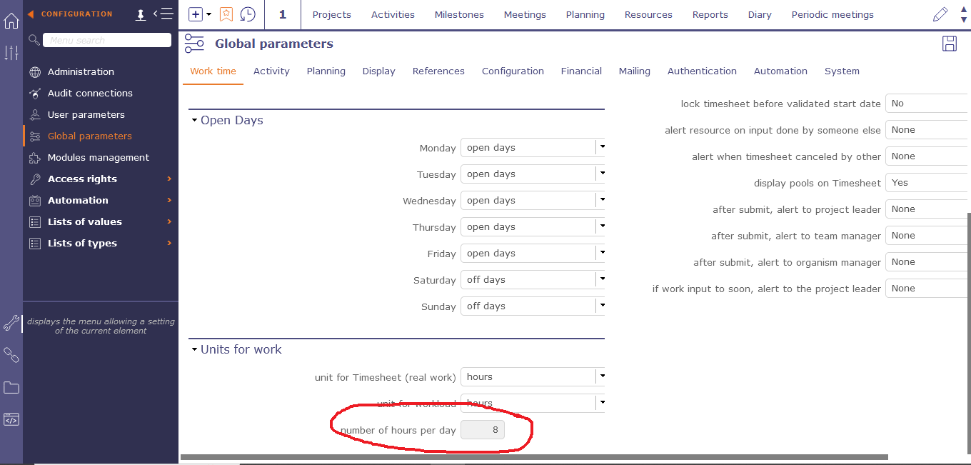

Hello to all,
I've read everywhere that we could change the work time per day in "Global Parameters". It's set up by default to 8 hours / day and I'd like to change it. But in my session I can't change it, it's grayed out... (see image attached). Can you tell me what's wrong ?
Thanks,
A.

Replied by babynus on topic Problem changing work time
It is greyed because you set display/inpout in hours and you already have real work entered.
You must understand that projeqtor stores work in days.
So when you enter hours, it is converted, using "hours per day" parameter and stored.
So if you enter 8 hours, it stores 1 day.
Then if you could change "hours per day" parameter, let's say to 7, the entry of 8 hours would then display 7 hours (1 day).

Thank you very much, it worked!
