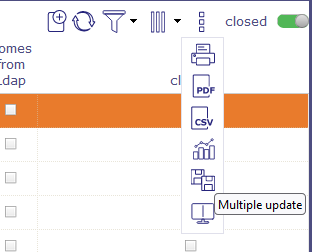

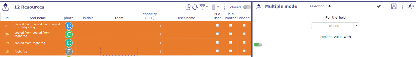

Have you tried the multiple update feature on the resources screen ?
As you can see, you can select which resources you want the change to be taken into consideration and the field to be changed. Don't forget to hit the "save" button (disk) at the end.

Thanks for the suggestion -I am a fan of this feature.
Indeed, this makes much less clicks! I have checked it and this is a workable backup solution if we cannot automate the solution.
Yet, I need some special filtering that is not available in the app. I can get along by making the most of the exisiting filter and cheking by myself, since the addtional filter capability is marginal. The issue with marginal selection (I mean selecting on the screen a few lines among tens) is that this is prone to errors.
