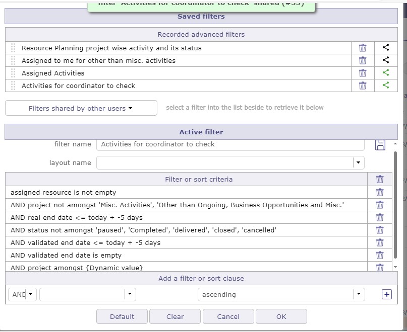

I created an advanced filter using a "dynamic value" for the "Project" field in activities and saved it as "Activities for coordinator to check." When I use it, the filter works fine and prompts me to input the dynamic value. However, when I share the same filter with another user, it does not prompt them for the dynamic value input.
I've attached a screenshot of the filter query. Could you please assist me with this issue?

Dynamic filters are activated only when selected in the list of advanced filters.
You may have noticed that when you define a dynamic filter in the Advanced filters pop-up, when you validate it, it is not applied.
Same occurs for shared filters, their definition is retreived when selected in Advanced filters pop-up, but when definition is validated dynamic values are not "triggered".
So to benefit of dynamic values for shared filters, users must save then to make them their own stored filters. Then, they can activated them through stored filters lists.
