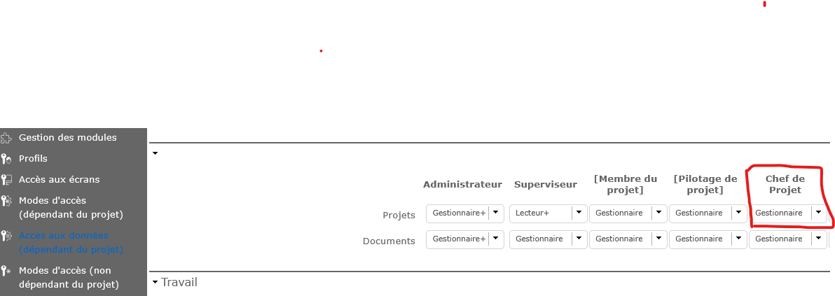

Hello,When I copy a template project, I don't automatically find it in my projects. I even get a message telling me that I don't have access rights to this project element.
I can't find the setting that would allow me to avoid this error. Setting the project to manager+ doesn't meet my needs because it shows all the projects.

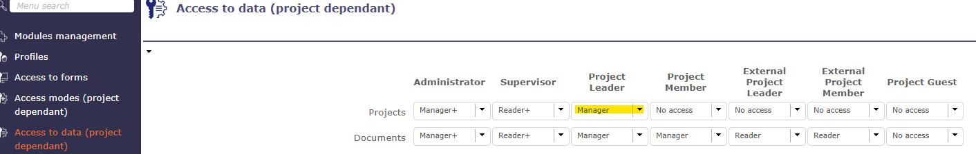

What access does the user in question have to the projects?
In my case, the project leader will only see his projects and will be able to copy the model project.

But this profile has the good access.

When you copy a project (template of else) and you have "Manager" rights, an allocation for you on the project is automatically created.
This gives you access to the project.
It you remove this allocation, you loose access to the project you created.
