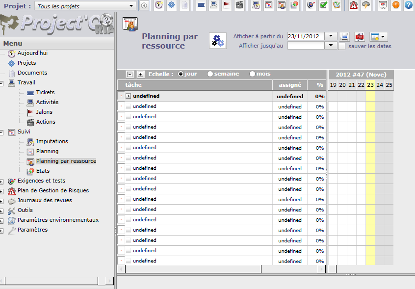

I just installed version 3.0 on a backup of my production, and planning is not displayed (the resource planning work).
The logo rotates and there is no display.
I joind my log this morning.
Thanks for your help.

23 Nov 2012 20:41 - 23 Nov 2012 20:43 #3 by F.Cheminade
Replied by F.Cheminade on topic Re: Pb V3 Planning
I come to you, because I still have the problem with version 3.
For installation, I make a copy of the database and files of version 2, I moved files from version and I refresh my browser cache then I run the website that tells me a job on the base. The connection is OK, all my tasks are present and everything works fine except the two parts of the schedule (GANT). You can see the screen shot.
For information, I've been testing on both platforms XAMP and Easyphp, but it's the same result.
Thank you for your help.

23 Nov 2012 23:27 #4 by babynus
Replied by babynus on topic Re: Pb V3 Planning
Very Strange.
I never met this kind of issue.
How did you copy your Database ?
It seems you have lines with empty fields (name = null).
Can you check :
- the completness of your database tables
- the parameters.php file : acces to database, including name of database and prefix for tables
- carefully check planningelement table : it seems refName has not beeen copied properly.
Regards.

29 Nov 2012 22:49 #6 by F.Cheminade
Bonjour,
Le fait de créer une nouvelle activité a débloqué la situation. Vous pouvez faire le test vous me dirais si c'est OK pour vous.
Cordialement.
