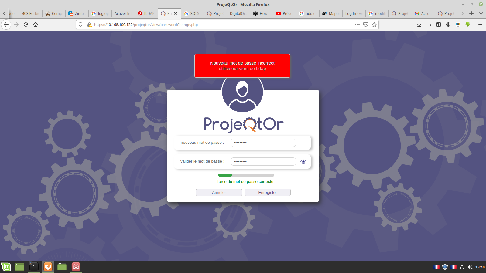

j'ai installer projeqtor sous centos et le configurer avec openldap ,l'authentification est fonctionne correctement et les utilisateur peuvent acceder mais le changement de mot de passe ne foctionne pas

hello I installed projeqtor under centos and configure it with openldap, the authentication is working correctly and the users can access but users can't change password

This is normal, user connected through LDAP cannot change his password (it is what error message says).
User cannot change LDAP password from ProjeQtOr.
Change paswword is valid only for Internal connection.
