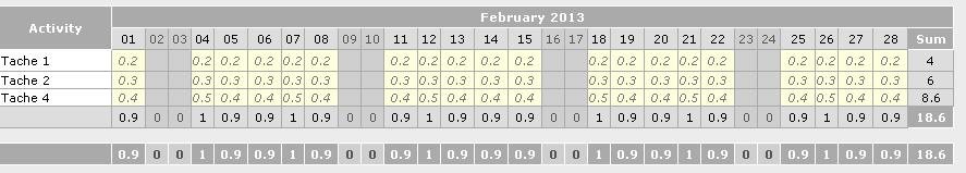

I have a problem planning.
See my document attach for the graph
Problem 1
I have 4 spots with such constraints: Regular between 2 date.
Each to the same resource
I calculate manually the delay to check the workload
My workload shift 1d ... It's strange? It does not calculate the total but 0.9j 1d. So it shifts a day.
Problem 2
All activities are "as soon as possible"
Assigned the same person.
Activities 1 and 4 are 450 priorities, activities 2 and 3 priority 500
1) Why it shifts 4j Activity 4? (Milestone fixed without delay?)
2) Why Activity 4 is not done before the event 2?
29 Jan 2013 22:36 #2 by babynus
Replied by babynus on topic Re: problem planning
Problem 1
It is just because of rounding. The work you assigned to task 4, distributed between dates, should be 4.3... So planning will round to 5 or 4. It should lead to the last day to 0.5 without having enough availability. So 0.1 must be planned the day after end date, visually shifting 1 day.
Can you check work planned for last day ?

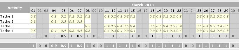

30 Jan 2013 09:54 #3 by JCDe
Replied by JCDe on topic Re: problem planning
I completed the document
Problem 1: Add the workload for 3 months. We see that shift 1.4 days because of rounding
Problem 2: I added a view of all activities + milestone. For dependencies we see on the GANTT view
30 Jan 2013 22:19 - 30 Jan 2013 22:19 #4 by babynus
The shift is "normal" (at least I dont' know how to avoid it).
It is becauses tasks 1, 2 and 3 are planned before.
So is does not leave enough availability of resource to finish before.
This is a very particuliar case : regular between dates for several tasks at once.
Maybe an improvement can be brought, to fill availability in the beginning of the defined period. But it should complexify planning calculation.
To be studied as a later improvement.
Ticket #976
Last edit: 30 Jan 2013 22:19 by babynus.

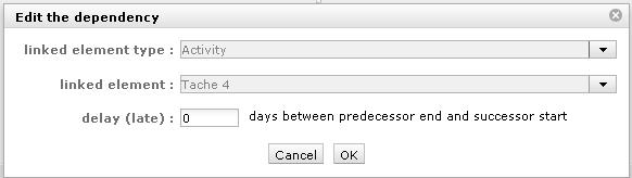

I recorded Ticket #977.
Are you sure there is no "delay" between milestone and task ? (check by editing dependency)
31 Jan 2013 10:38 - 31 Jan 2013 10:39 #6 by JCDe
Ok,
Problem 1:
What I do not understand is that during the month of February to early March there are activities 1, 2, 4 => There is the problem (total = 0.9 or 1).
Then from March 8 activities were 1, 3, 4 and he manages to complete the day (total = 1), very strange ....
For problem 2: Not delay :
I repeat the same data for problem 1 and 2, I only change the mode plannind "regular between 2 dates" => "As soon as possible"
