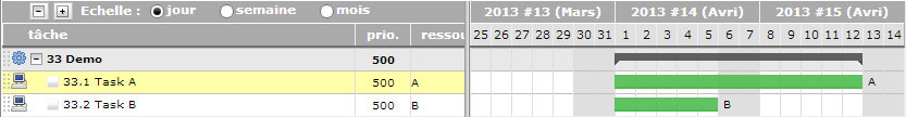

Let's say you have tasks A an B. What you can easily know (I guess) is : how much work is needed to execute each task. For instance A is 10 man*days, B is 5 man*days.
OK.
Now, what about duration of these tasks ? You may assume A is 10 days, B is 5 days.
I will not. My answer is : all dependes on assignment.
If you only have one resource working, then possibly it will fit your first guess :

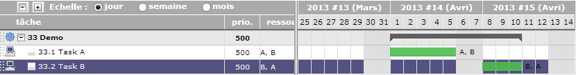

If you have two resources, things may slightly change if you assign one task each :
And you can change all things if you split the work on each resource for both tasks :
Now, it's up to you to know who can work on each task, if several resources can work on each task, and so on. You will then get a real planning no only a beautifull Gannt with some bars on.
