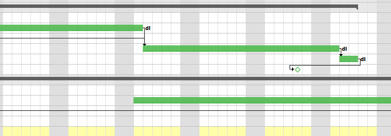

if i understand, the task priority is use to build planning in the same project. Is it possible adjust project priority, when a ressource is affect in two project ?

according manual, activities planned on priority. A constraint to a project is not mentioned. In my experience, only priority influences planning. If activiites have the same priority, then the sequence/order of tasks. See manual, section Planning, page 2/5.

than you for your answer. It's good. In fact i have a reesource with ETP=0.7 . At the end of the first task in project A, the successor is planned next day, but projector planned one day for Project B. (see screenshot). This ressource is 100% on project A and 100% on project B.
