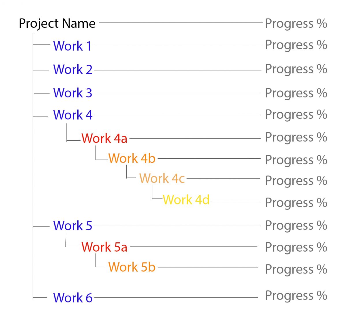

I have to keep track in the planning of all the tasks of one project.
Work and subwork must be approved by a supervisor and the resource to whom the job has been assigned, must be able to change the % of progress.
How can I orgnaize my workflow? (ticket, activities, action etc)
thank you for your help
