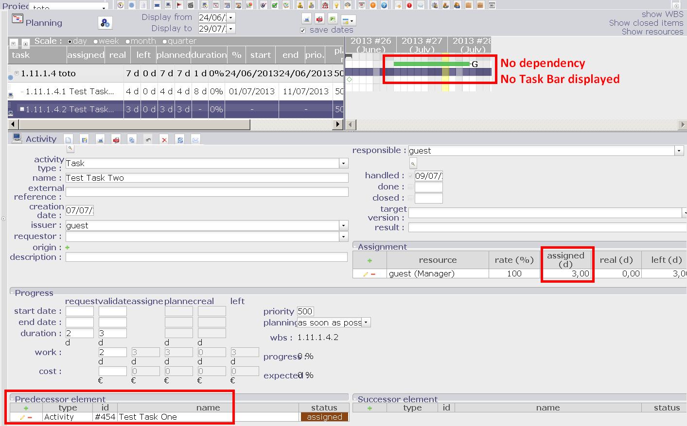

However, I tried for hours, I assigned resources and work, changed all possible parameters, but cannot see the dates of the Successor adjusted according to the Predecessor's.
Also, on the Gantt the bars of both Successor and Predecessor are displayed independently from the Assigned Work: they seems to be based only on the Dates, which are independent from the Assigned work. This would mean that they are Duration driven, are they? How can this be changed please?
e.g: a task with 3d between Start/End Date, 5d of Assigned Work (100% Resource Allocation), and asap Planning rule (Effort/Work driven), should automatically adjust dates and duration to 5d; instead 3d duration (or start/end dates difference) is displayed.
Please see the attached screen.

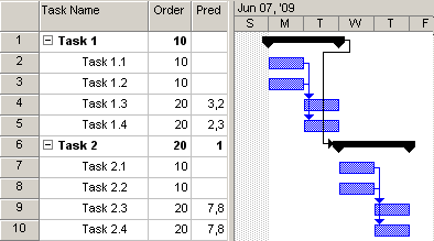

As expected behavior I had in mind the usual scheduling assistant: if in MS Project, OpenProj, or ProjectLibre, you make a task dependent from another, and work/effort driven, its start/end date will automatically be calculated based on the end date of the predecessor:

Thanks, unfortunately the display is still independent from the work. The Predecessor for example: I set 2d duration and 5d work, and the bar is 2d only; even if I set 50d work, it will still display 2d; if I do not set anything on the Progress start/end dates fields, it will not display anything (empty row).
There is one important restriction : if successor has some real work, the task starts at first real work input. So it may be before predecessor end date.
I also considered that, I checked and there is no Real Work. If you have a look at the screenshot, it's from the Successor details and the "real (d)" field is 0,00.
I also removed the date from the "handled" field but it did not change anything.

About your're issue, it is just about the resource "guest" : so much used, it has no availability for several years... Planning stops searching more than 3 years in the future...
So I created a new project "Simple Working Project" : the last in the list.
Just created 2 tasks : each one assigned to a different resource (not guest please !!!)
Run planning : tasks are planned in parallel
Add a dependency. Run planning again : tasks are planned one after the other.
Regards.
