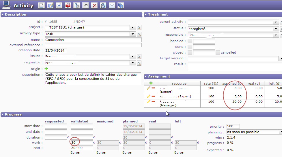

Is there some work for activities ?
If activities as no work allowed, you can't have a planning.
For exemple, see attachment (activity completed for "as soon as possible" planification)

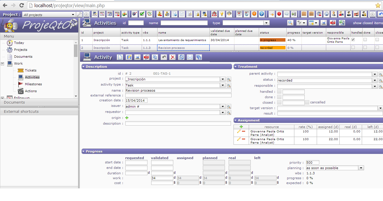

22 Apr 2014 22:28 #16 by Marce386
Replied by Marce386 on topic Creating a new project
I checked and the activities have some work
I went back to get to planning screen and nothing ..
I have done everything you told me and I can not
help me
