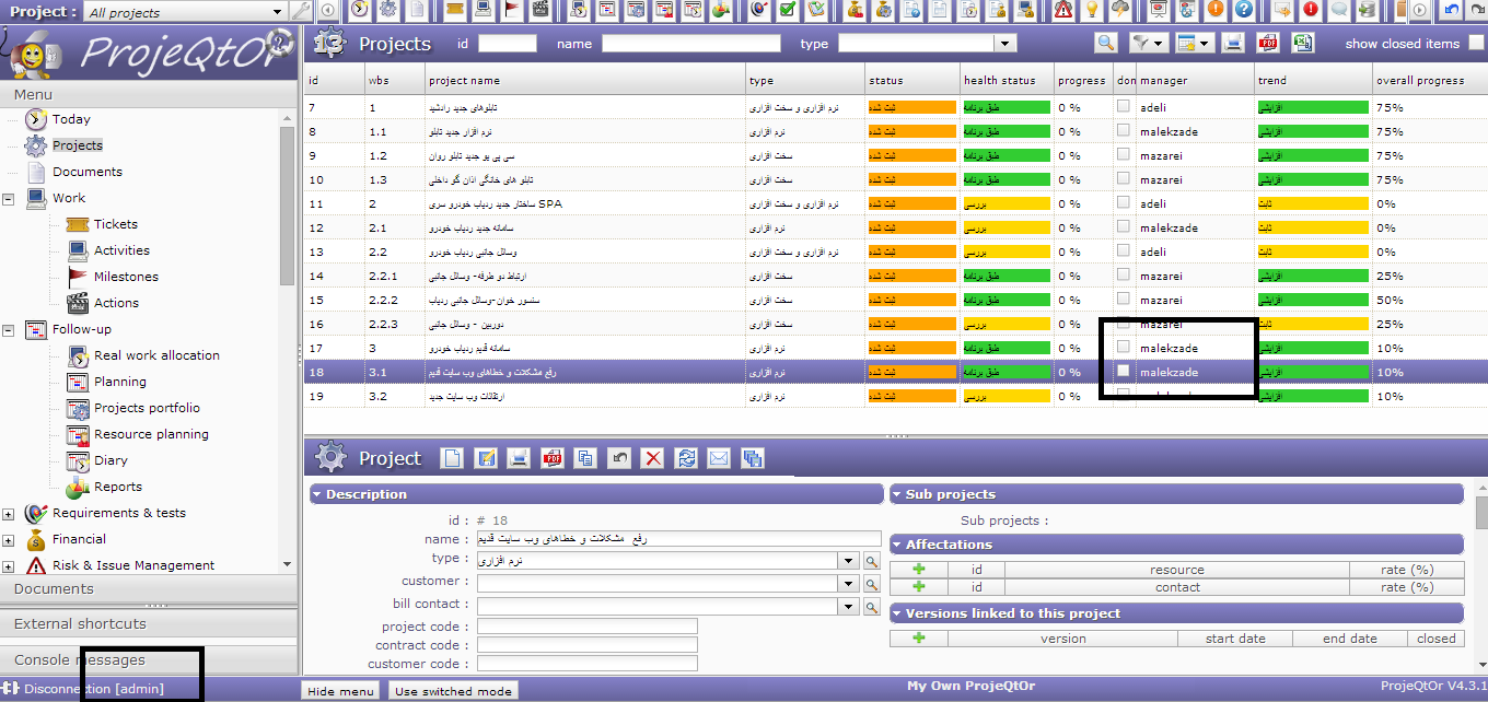

I've created a project
  I compared the manager it to a user
  Unfortunately, when the user login to the project that project is not on the list.
Where did I go wrong?

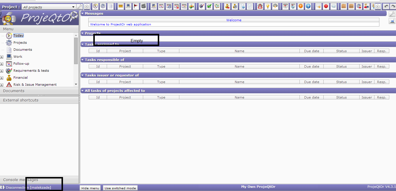

23 Jun 2014 12:41 - 23 Jun 2014 12:43 #3 by Adeli
Thank you for the answer
I'm sorry
I did not ask my question correctly
I'll define a project as the admin user
I'm in the project manager defined the user
When the user enters the peojeqtor a project that we can not see in your list
why?

23 Jun 2014 12:51 #4 by Adeli
hi
why the project not in list of malekzade user's?
23 Jun 2014 14:13 #5 by babynus
Because no resource is affected to the project.
Just click "+" in affectations list for project to add malekzade as project member (being defined as Manager is not enought, as it is mostly an informative data)
