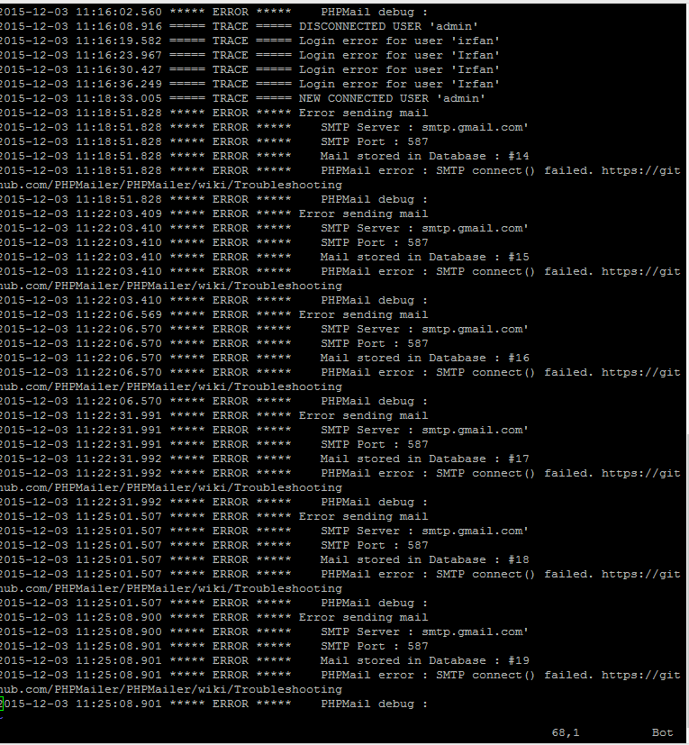

at the first time i try to send some mail to admin it works..
but lately it send some error message..
when i check to the logs it return this message..
so i follow the link but it has so many option to check..
can you tell me where exactly to check every steps there? thanks...

03 Dec 2015 12:36 #2 by babynus
gmail refuesed your smtp connection.
Check that password is still correct (maybe the account you are using changed password)

13 Jun 2017 19:34 #4 by madrilene59
i had the same problem.
i change the method of sending mail in administration.
and it's works
16 Jun 2017 15:32 #5 by saadia
16 Jun 2017 20:47 - 16 Jun 2017 20:48 #6 by madrilene59
i went to global parameters
then middle page right emailing section
the last item is for me sending method
by default, it was phpmailer library
i switch it to function phpmail
and it's works
