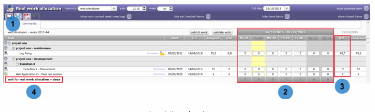

- Now, the activity cannot be removed from the Real work allocation screen as there is still left work of 7 h.
- The activity also cannot be closed due the error Invalid controls. Unable to close an element with left work.

Just set left work = 0 => it is exactly the reality.
8 hours were assigned, 1 hour only spent, left is zero, so work is complete and reassessed is 1 hour.

You made me notice that left work is editable by both the resource and the project lead. I have not tried to edit left work previously and didn't even notice that it is an editable text field :oops: I thought it is always calculated from assigned - real.
