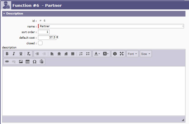

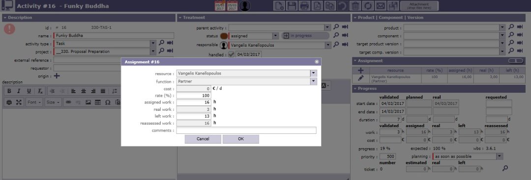

I have created an activity but I don't see any cost. I did the following steps:
- Created a new Function: Partner (with default cost 100 euros)
- Created a new Resource: Name with Main Function Partner
- Created a new Activity: Resource (the above Name) and assigned work: 16, status:assigned
However I do not see any cost data (e.g. assigned)
Any idea?
Vangelis

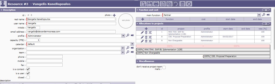

04 Mar 2017 19:42 #2 by babynus
Replied by babynus on topic Activity Cost
You must define a cost for the resource and its main function

05 Mar 2017 09:01 - 05 Mar 2017 09:01 #4 by Vangelisk
Replied by Vangelisk on topic Activity Cost
I think I have done these. Please check the attachements.
Thanks,
Vangelis

@Vangelisk
Sure, you did not define cost for resouce :
Defining default cost for function is not enough. It is just the value that will be proposed when you create resource cost.
So on assignment, cost is set to zero
