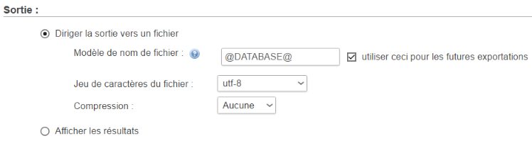

I realised an export of my database using PhpMyAdmin with the standard parameters for "jeu de caractère du fichier
As result, I lost all characters like é à ' ù , etc. Here are some exemples

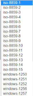

What do I make for choice in the list to keep theses characters ? Here is what I have in the list

Normally , you have to choose the format UTF-8 but ... If your database is not in format UTF-8 it's a little problem .
Since 4.4 , all database are in format utf-8 but if your database is older than 4.4 it's possible that it's not utf-8 .
Then , if in utf-8 you have problem , you can use the format windows1252 or iso8859-15.
For the export it's the same format than the import.

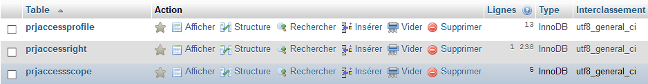

All my tables (without exception) in the Database are like this example :
But I've this information at the end of the list of all the tables :
So, I don't understand anymore :blush:

28 Mar 2017 11:44 - 28 Mar 2017 11:45 #4 by babynus
You database is in Latin 1, so I guess you should export in Latin 1 to get correct display of accents.
What happens is that you store UTF8 characteres in non UTF8 database.
This is not blocking for ProjeQtOr as this just characters stored are correctly understood as UTF8, so correctly displayed.
