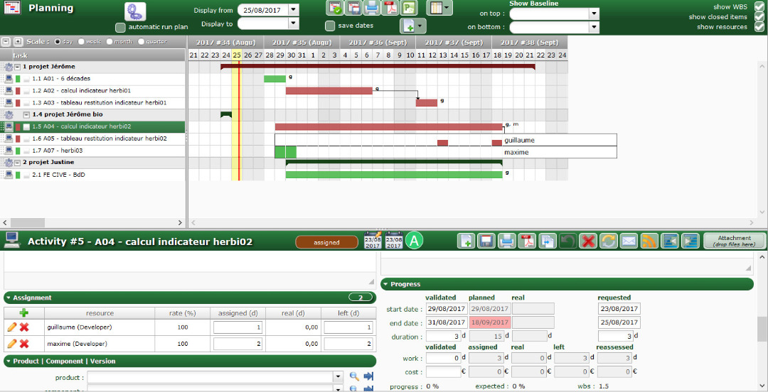

Maxime has been assigned on 1.5,1.6,1.7 tasks.
Scheduling calculation didn't take into the fact of Maxime is days off and come back to 29 August.
The difference between (1.5,1.6 tasks) and (1.1 task) for example :
- 1.1 -> only resource assigned
- 1.5,1.6 -> 2 developers resources assigned (1.5 : 3days for this task | 2 days for Maxime, 1 day for Guillaume)
CHANGE : delete Guillaume's assignment of 1.5,1.6 tasks | add 1 day of Guillaume to Maxime

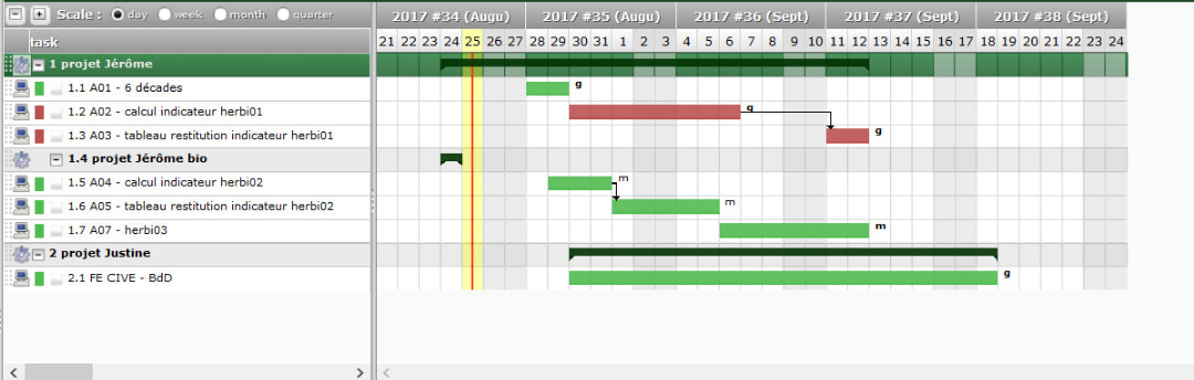

The difference between (1.7 task) and (1.1 task) for example :
- 1.7 -> 2 resources assigned (1.6 : 3days for this task | it's twice the same resource : Maxime (manager) : 0 day, Maxime (developer) : 3 days)
REMARKS : strange, Maxime (manager) with 0 days shouldn't be a problem, so what.
CHANGE : delete Maxime (manager)'s assignment of 1.7 tasks
i run scheduling calculation (even if it run automatically after assignments changes).
Now, planning seems to be correct, and Maxime begin to work 29 August, and not any task overlaps with other task.

Following some modifications, i modified again the 1.5 task like that :
- guillaume (developer) : assigned with 1 day
- maxime (developer) : assigned with 2 day
Now, planning seems to be ok.
