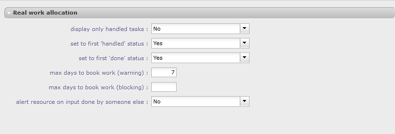

is it possible when you book time at ‘real work allocation‘ for the first time for an activity that the status will automatically be set to ‘in progress’?
Yes, this is default behavior. You'll see a small green flag that will inform you about the change.
This automation can be disabled in global parameters screen (tab "work")
Because normally if you have no more time left, the status will be set with the last booking to ‘completed’.
This is also available, and set as default behavior. You see a "finish" flag, but it may be stiked if move is impossible (for instance if result is required and not set)
This automation can also be disabled in global parameters screen (tab "work")

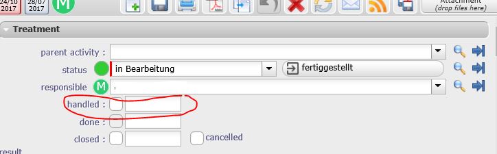

This works now. But there is no check in the box and date of handled. Is this a bug? Or is this normal?

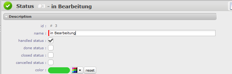

25 Oct 2017 11:02 #4 by babynus
It depends on configuration of your status.
The status must "check handled"

09 Nov 2017 12:06 #5 by #Chris
we have in the status checked handled
and also set in the global parameter the "set to first handled / done status" to yes
But still there is no automatically check in the box at handled or done if we book time at ‘real work allocation‘. And also no date will be set.
09 Nov 2017 13:46 #6 by babynus
On activity type, set handled as locked to ensure it is automatically set from status and never manually changed.
