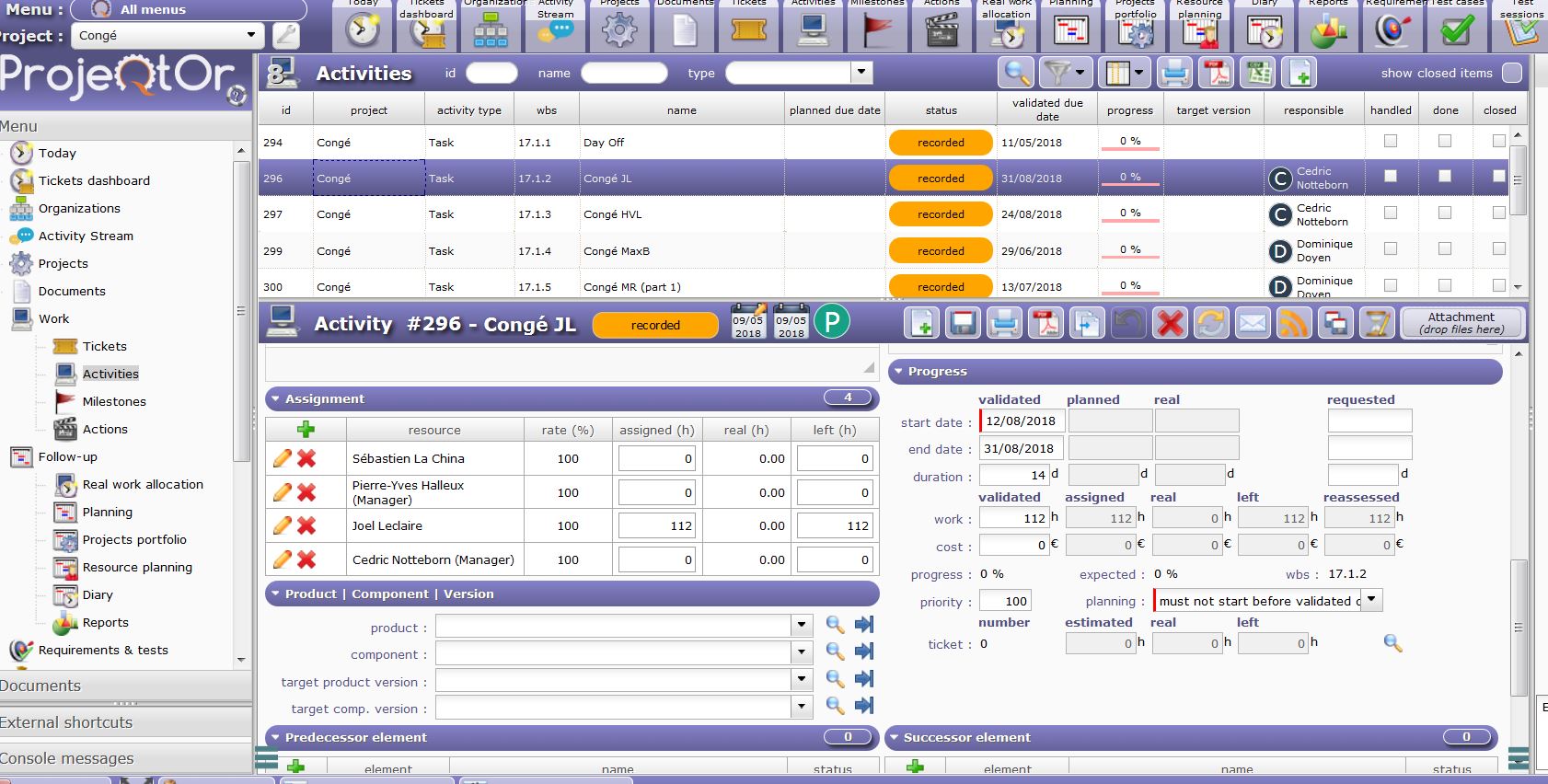

I face difficulties with holidays. I have created an administrative project, put the day off as planned activities, but I cannot see any planning of this specific project (there is no planned date while there are validated ones) and the days off are not taken into account into the scheduling of the other activities.
What did I miss ?

You cannot "plan" administrative project (they are not real projects)
Resources just record real work in the future to indicate they will be off duty... and planning won't use them these days.
