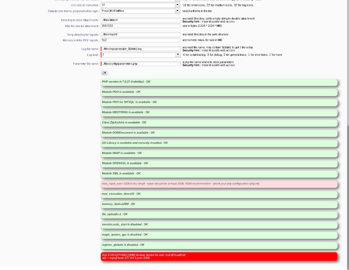

When i launch first configuration in my local host computer , i received this message
what i must to do to resolve this problem
thx
08 Aug 2018 16:47 #2 by babynus
Issue is clear and has amready been reported here several times : access denied on DB access.
It means credentials to access DB are wrong.
Check your install to know correct credentials.
On WAMP, XAMP, MAMP, you may try :
- root/mysql (it seems the one you tried)
- root/ (no password)

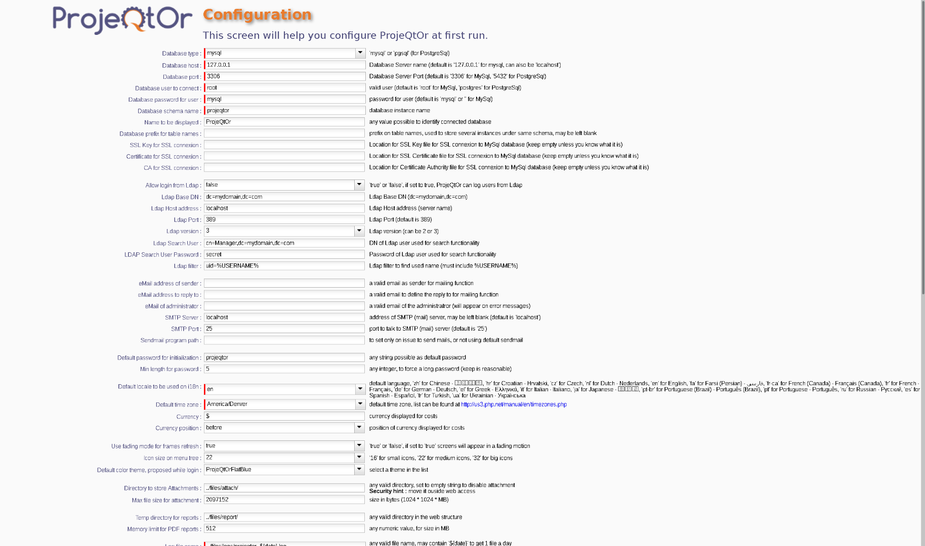

08 Aug 2018 19:41 #3 by rvasighi
Could you explain more clearly, what is the meaning of this:
what am i dining in configuration windows?
-root/mysql where is it? root is the name of folder or its mean that root !
08 Aug 2018 20:55 #4 by babynus
It means
db user = root
db password = mysql
or
db user = root
db password = (leave empty)
08 Aug 2018 21:02 #5 by rvasighi
Thank for answer,
I tried the second option
db user = root
and error massage change as follows
:incorrect value for 'Log file name', cannot write to such a file : check access rights
the value in log file is: ../files/logs/projeqtor_${date}.log
