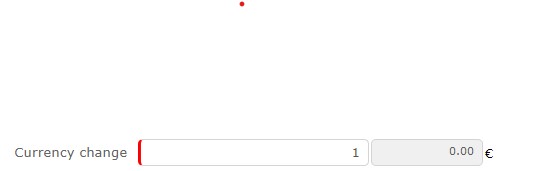

I have a small issue concerning the width of custom fields: sometime rectangles containing long strings are smaller than those containing short strings and viceversa.
Additionally, fields of the same type (both reference to the same element, both varchar of the same lenghts,...) have different width.
I copy here some examples:
Departamento and Area are both refernce fields to idOrganisation. However one is much bigger than the other one, and the text in the second one is cut.
Currency-change is of type decimal(7,2), the one next to it is of type decimal(20,2). However it is much smaller than the previous one.
Is there a way to set the width?

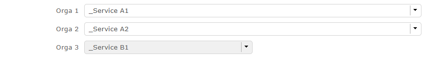

30 Oct 2024 10:41 #4 by babynus
About list fields, possibly you added some attributes that reduce the size.

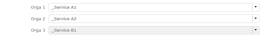

I just tested adding 3 fields pointing to Organization, 3 have same width
Possibly you added attribute "same on same line". This reduces the with (so that the next can be displayed on same line)
