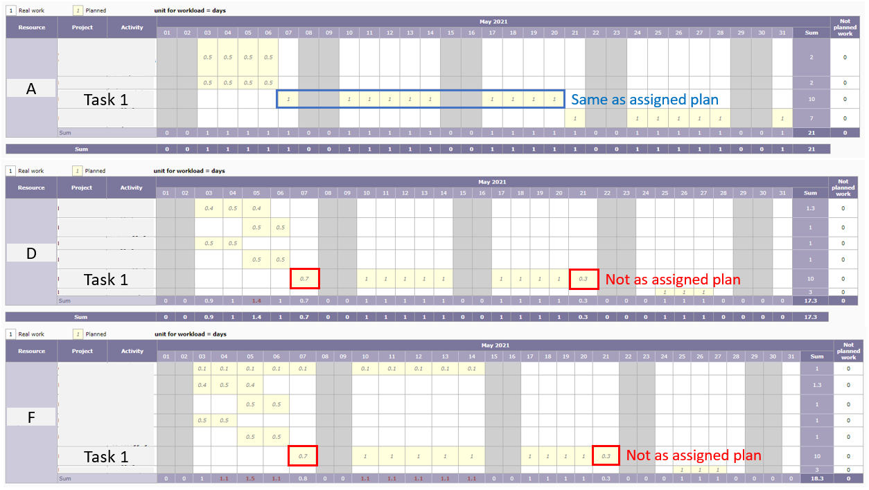

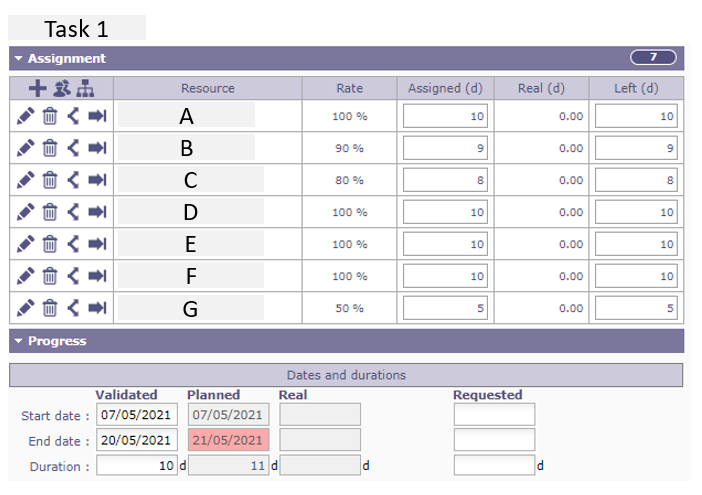

Just want to check if the cases mentioned in previous post are normal or there are bugs/setting issues in the calculation. I tried to repeat a case mentioned and attached the screenshots for your reference. The task validated start date is 2021/5/7 and end date is 2021/5/20 with planning mode as soon as possible. In the assigned resources, a few have work allocated on 2021/5/21 instead, while they have capacity on 2021/5/7 such that the work can be distributed within 2021/5/7 and 2021/5/20. In the plan calculation, the planning calculation option - "Plan with overuse (infinite overbooking capacity)" is selected. Is there any issue in the calculation or settings required?

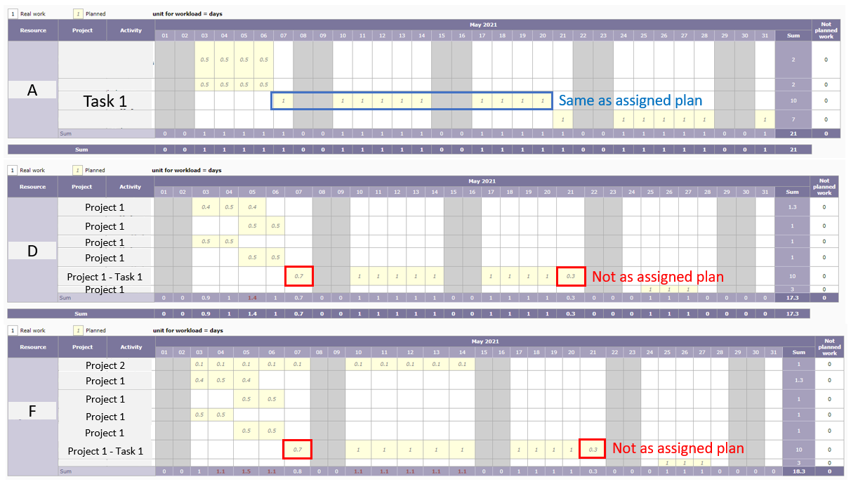

Many thanks for your explanation on the calculation. I think the situation you mentioned does explain for some of the cases, while for the case mentioned in previous post, for resource D and F, all the tasks assigned to them are shown in the screenshot. For resource D, all the task shown in the screenshot belongs to the same project. For resource F, except the first row, other tasks shown in the screenshot are the same project as resource D. If accordingly to your explanation, day May 7 should be able to plan workload = 1 day such that the workload would be allocated through till May20 instead of May 21, right? Please advise there is any misunderstanding. Thanks!
14 Apr 2021 08:56 #6 by babynus
Replied by babynus on topic Planning Calculation Logic
There seem to be something that take 0.3 days for each on may 7th.
A Meeting ?
Some already entered real work ?
