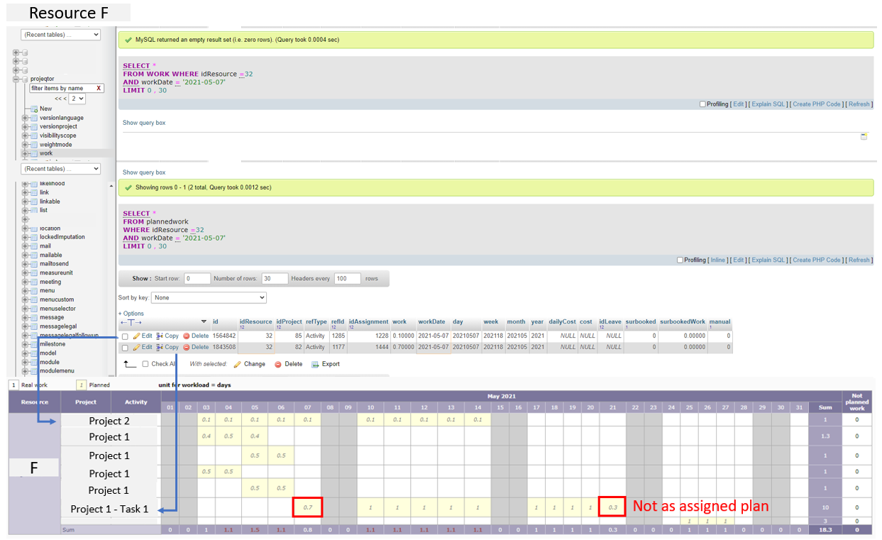

Hi Babynus,
I rechecked that there are no meetings or real work entered in May, which is why I found it weird.
Thanks,
Rainbow
14 Apr 2021 17:26 #8 by babynus
Replied by babynus on topic Planning Calculation Logic
Seach in the DB.
If id of your resource is X,
To find real work already booked :
select * from work where idResource=X and workDate='2021-05-07';
Then to find plannd work for the resource :
select * from plannedwork where idResource=X and workDate='2021-05-07';

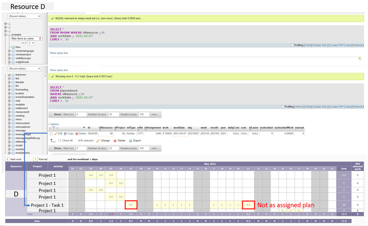

15 Apr 2021 04:02 #9 by rainbow
Replied by rainbow on topic Planning Calculation Logic
I searched in the DB with the following results which is the same as the work plan report.
For resource D:
For resource F:
15 Apr 2021 08:27 #10 by babynus
Yesy, very strange.
Could you please try and reproduce use case on the demo (demo.projeqtor.org) so that we can analyse the situation ?

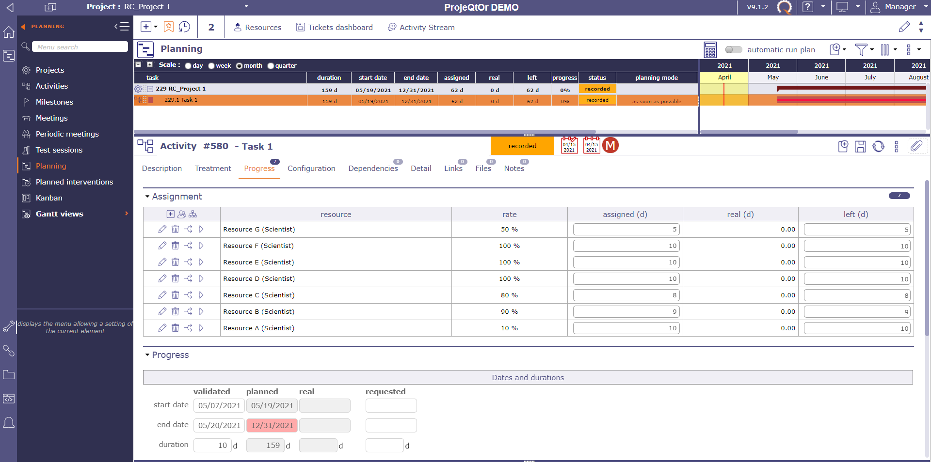

15 Apr 2021 10:06 - 15 Apr 2021 10:07 #11 by rainbow
I inputted the task and the resource info for the task mentioned as activity #580, validated start date = '2021-05-07' and validated end date = '2021-05-20'. However, I tried to run the calculation but the planned start date couldn't be planned on '2021-05-07'.
