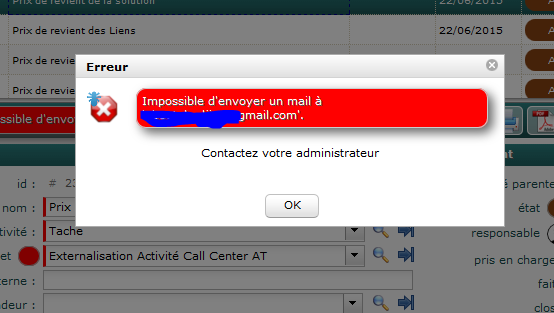

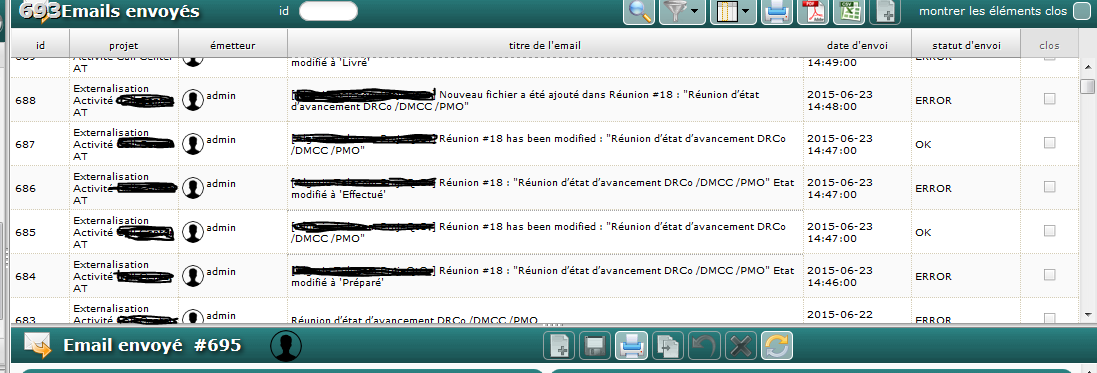

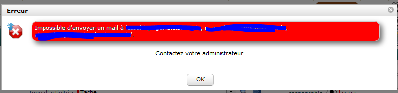

23 Jun 2015 16:19 - 23 Jun 2015 16:22 #15 by anisdz2015
I made all possible tests, the same error message when sending is done manually, I even tested sending meeting invitation
see snapshots

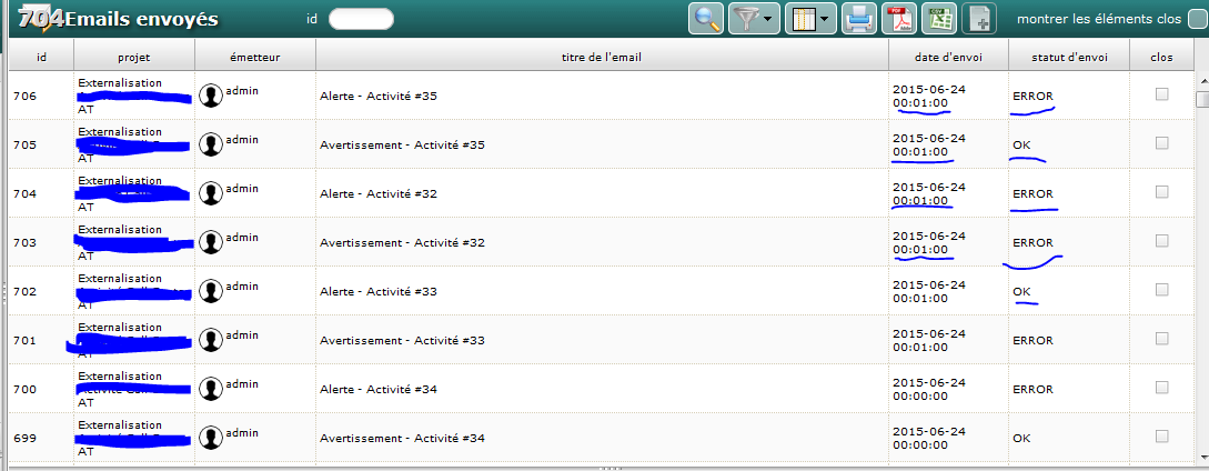

24 Jun 2015 12:54 #17 by anisdz2015
I tested with a single email and it is the same error message
I just saw that I did not receive all the emails sent by project yesterday at 00:00
View Screenshot
I will do another test I will change SMTP server to be sure it is not the mail server that kidding and I will inform you
24 Jun 2015 13:30 #18 by babynus
What is strange is that some emails are correctly sent.
Not all fail.
So I would bet on SMTP server or more possibly some network issue (possibly some proxy playing with connections)
