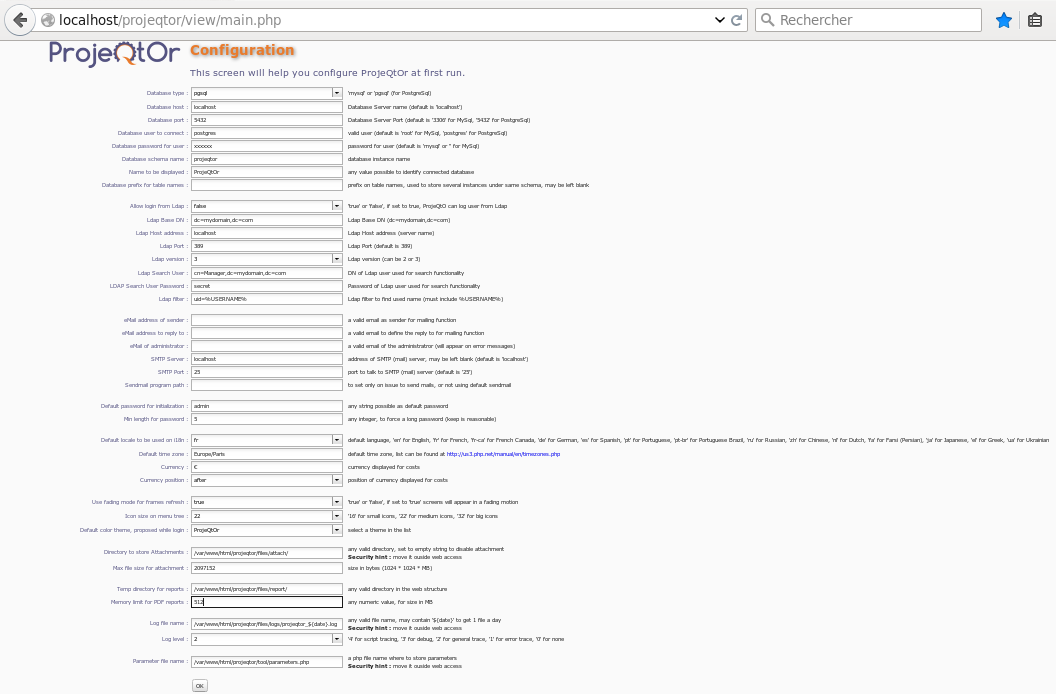

Installing CentOS 6 projeqtor under x86_64 and postgresql 9.4 does not. I took the parameters in configuration in the "main view" GUI, and the system hangs. The log file is empty. :(
Can you help me?
Thanks for your answer.

Find in attachment the files which show the modules installed, then the interface of the configuration parameters. While pressing on “OK” button, it occurs anything, no error message, no log.
Note: the Apache server
File Attachment:
File Name: phpandapac...ules.txt
File Size:4 KB
functions correctly.
