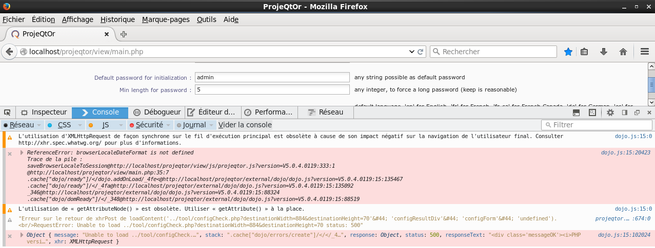

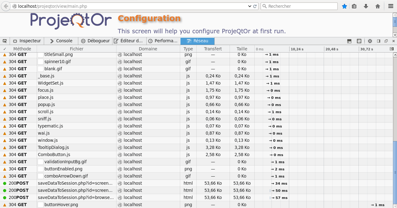

09 Aug 2015 01:31 #13 by babynus
OK,
Then you should have some Javascript error or none respondong server.
So, hit [F12] to open Dev tools.
1) Select "Console" tab : after running test, is there any error logged ?
2) Select "Network" tab : after running test, what is the latest request ? could you post here the response of this latest request ?
Thanks in advance.
10 Aug 2015 19:58 - 10 Aug 2015 20:12 #14 by Mams
Find below, the results of your request.
Thanks.

11 Aug 2015 09:15 #15 by babynus
You havr an error where calling configCheck.php (Status : 500)
I can see begining of response, which seems correct, but I need complete response to investigate.
In your find a call to configCheck.php : select this line in the table.
This should show new sub-tabs on the right.
Select "response" : copy complete response text and paste it here.
Thanks.
