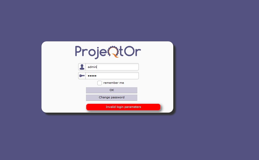

I spent 20 hours to setup your system with now result.

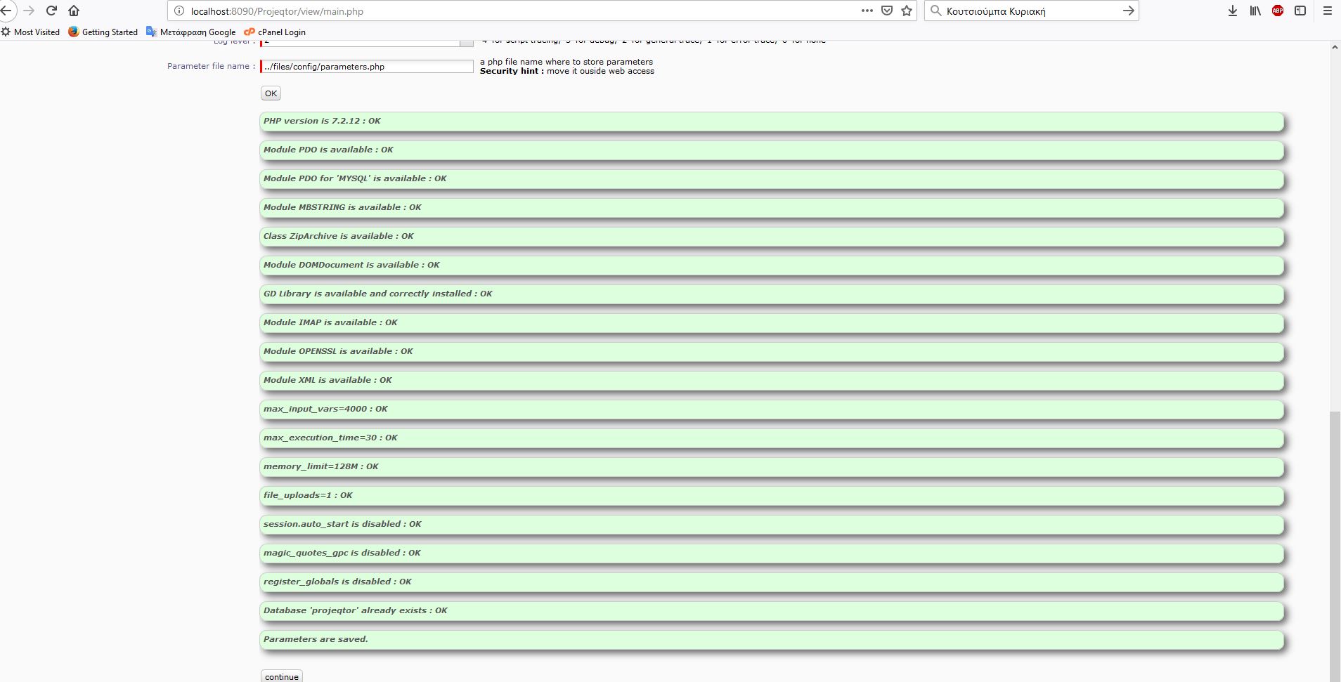

I have tried with 7.2.7 and 7.3.1 with XAMPP , all parameters in your check screen are green and OK.
I ve checked with phpMyadmin that the system has created the database projeqtor and the relevant tables.
The issue has to do with the 1st login attempt.
When i put user admin and password admin (as per your readme.txt file) the system responds with a red sign and the message "Invalid Login Parameters"
Bear in mind that my Apache has been configured to use port 8090 instead of 80 but this should not be an issue since ALL pages and other apps are working properly
Please advice
