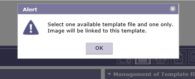

a. If I try and select Browse and upload image for template I get the error message below.
b. The uploaded template is not in the available template files list.
c. When in the description section, if you try and select the template file I uploaded it is not in the list to enable it to be select.
Please see attached file for screen shots of problems, test done. Your help would be appreciated as I can see the data could be in ProjeQtOr which they wish to have reported on for projects. But not how to do this is serval ways different plant managers and IT manager want.
Sorry, no image.

15 Mar 2019 17:31 #4 by babynus
Message seems clear :
before uploading an image you must select one (and one only) available template, in oder to link the image to this template.
15 Mar 2019 19:28 #5 by beverley
Thanks for the reply
Sorry I can not load an image into this reply, so I have attached another file to the orgial post, with screen shots trying to clearly show the problem.
If I could select the template I had created and upload from the available templates list I would, however the template does not appear in the available templates list to select !!,
It shows above the list of available templates box, never in it. Can NOT FIND A WAY TO GET MY TEMPLATE INTO THE AVAILABLE TEMPLATES LIST TO SELECT.
I hope this clarifies the issue I have.
16 Mar 2019 19:22 #6 by babynus
It was a& tto restrictive control for security : only admin could upload files.
It is fixed now.
Demo is patched.
