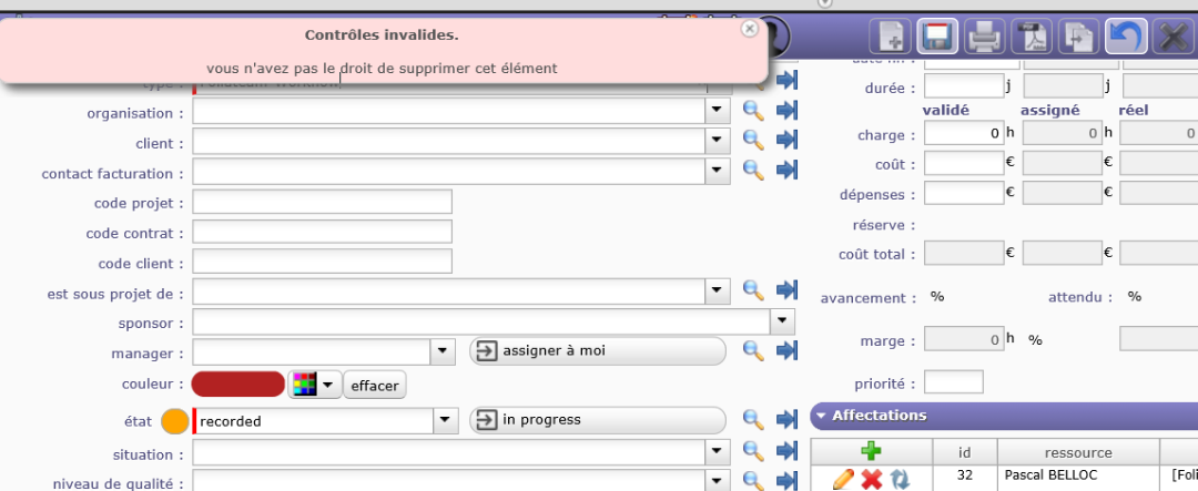

16 Mar 2017 22:20 #1 by chriscool
My project contains no activity no time allocation
I can not delete it
And I can not delete the assigned resources even as an administrator
What protection is blocking this?
We must remove the resources from the project and possibly remove it
Thank you for your help

17 Mar 2017 10:29 #3 by babynus
It seems to be an access right issue.
Did you change something in habilitation configuration ?

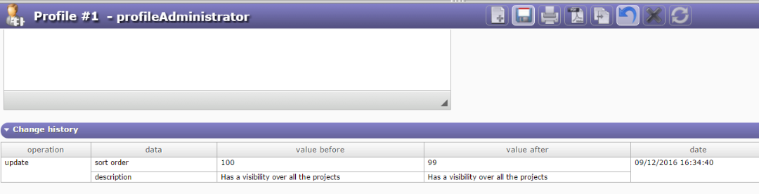

17 Mar 2017 17:15 #5 by babynus
It repeat my question : "Did you change something in habilitation configuration ?"
In default configuration, administrator has capacity to delete project.
But habilitations can be changed, even for admin.
Moreover, if admin is allocated to the project with anoter profile, he may loose hability to delete project !
